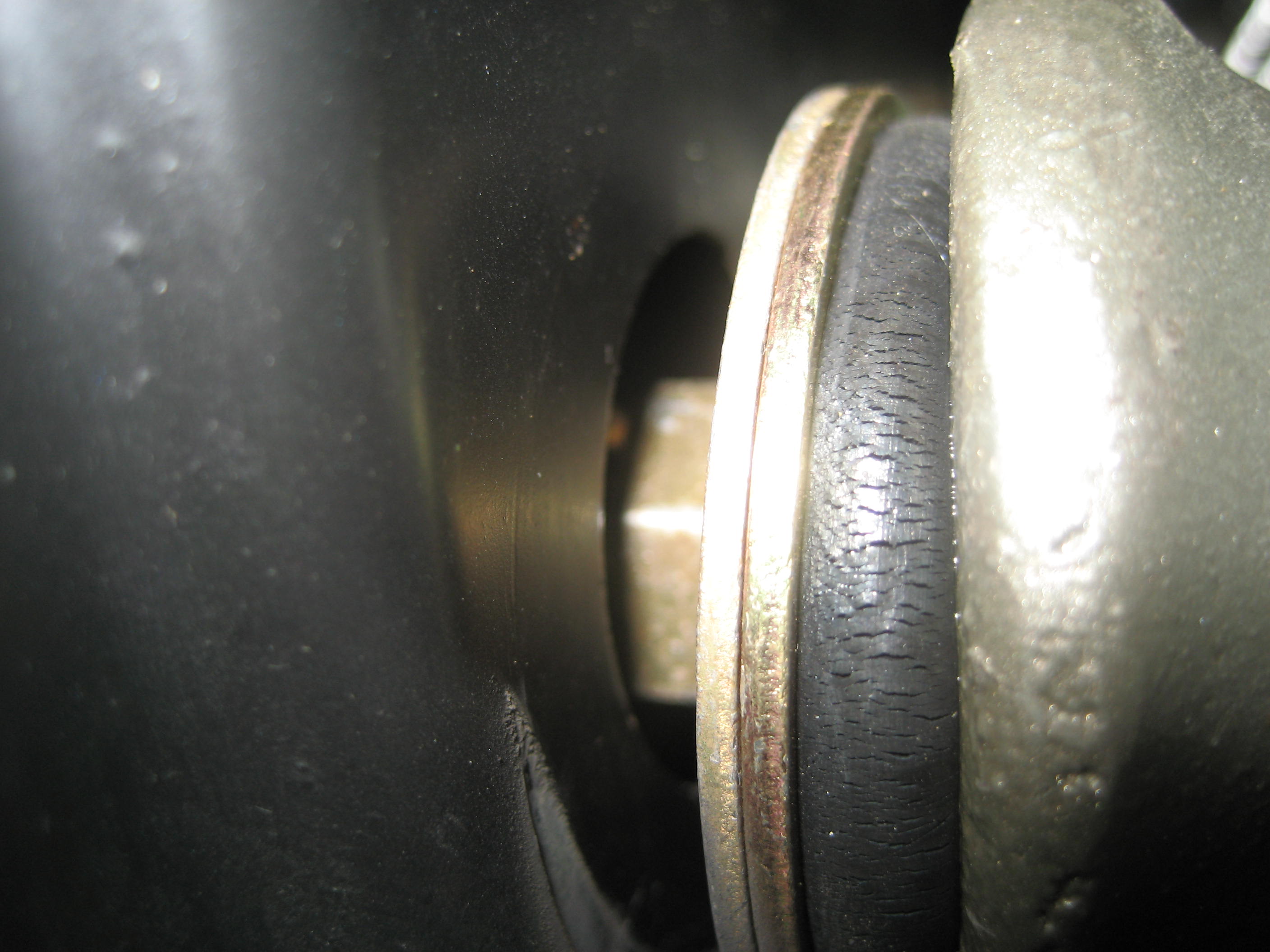

On my to-do list is replacing the engine mount bushings (C85-12 with conical bushings). Was wondering if there were any specific procedures or gotcha's involved with the process. Reason I would like to replace them is they are cracked around the exposed edges and I don't know when they were installed.

In recent years it seems that I've had the small "surface cracks" form where the rubber is compressed. For the past several annuals, I've actually replaced the bushings...just skipping one annual when we experienced that just a very slight loosening of tension saw the cracks totally disappear with no other deterioration apparent. I've tried new bushings from the normal suppliers as well as NOS & it doesn't seem to make a difference. At last annual the IA said he's convinced that they're OK with no need to replace (I still plan to replace again soon 'cause I don't like cracks!). Neighbor/fellow 140'er Tom Reddeck and I have joked that mine seem to show cracking sooner than his, our only theory being that I'm maybe 600' closer to the coastal salt air (200+ miles away) than he is :-). FWIW, I've tried with and without the spacers and it makes no difference...in the cracking nor in the engine vibration (I do find that more washers are needed sans the spacers, as John mentioned). Mac
