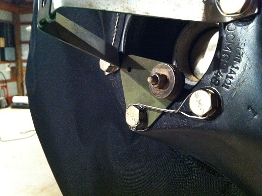

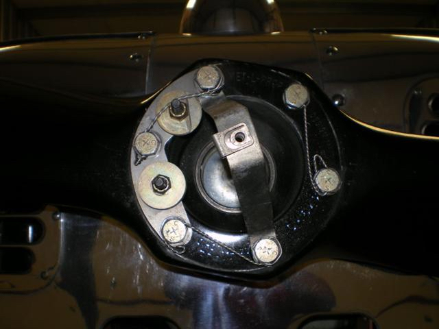

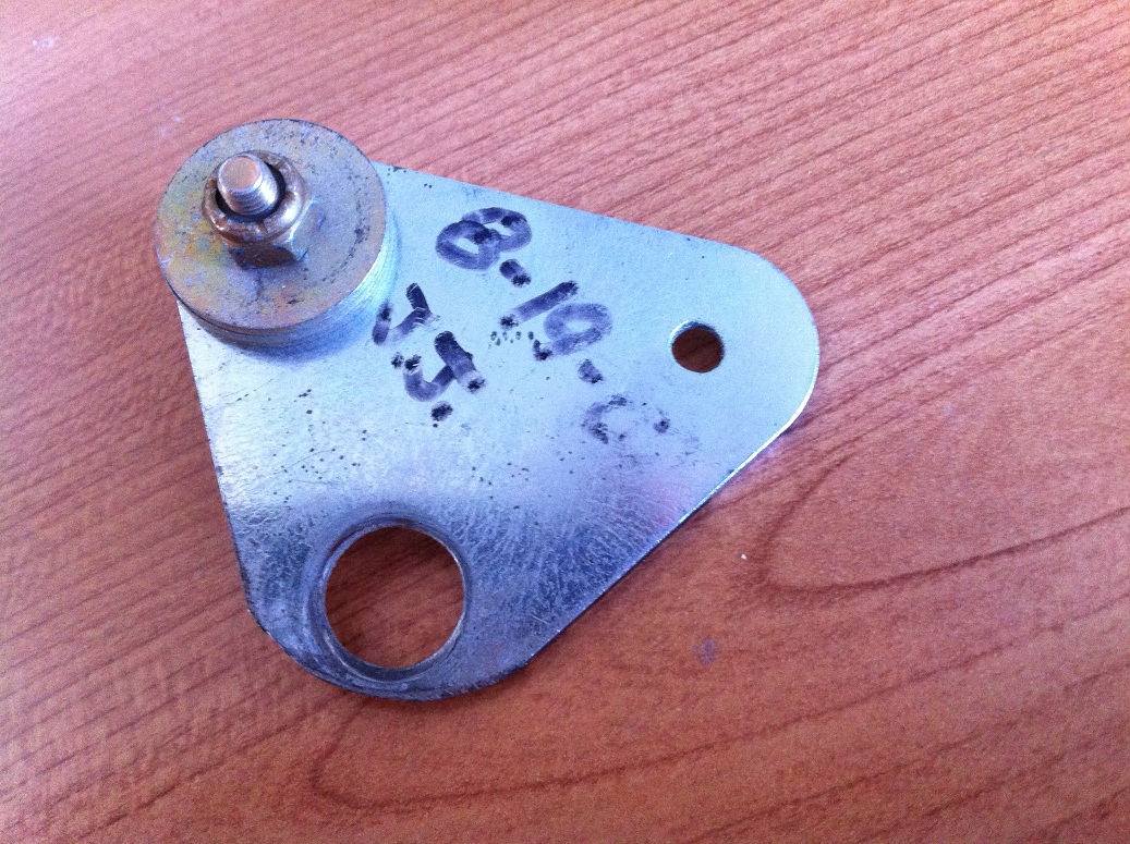

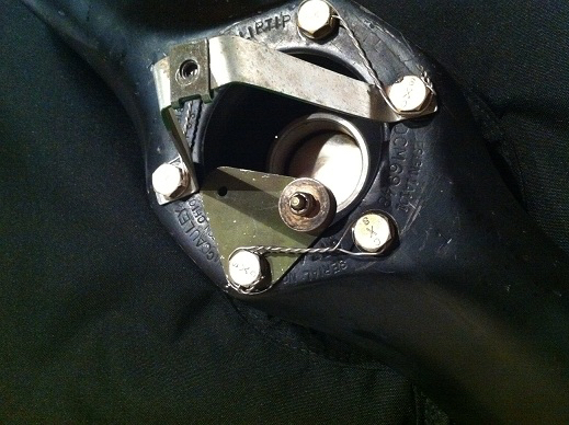

I have done Dynamic Propeller Balancing in an AcroSport Biplane that I built. This Biplane had a big aluminum spinner and it was fairly simple to add washers on the outside of the spinner to get it properly balanced.
My 47 C-120 with a C-85-12F has a little spinner with one bolt in the center. I have searched the forum but have not found anything about prop balancing. Do you have any suggestions/ideas on how to add weights to dynamically balance this McCauley aluminum prop? I guess I could use automotive stick-on tire weights but I am concerned that they will fly off!

Re: Propeller Dynamic Balancing
I don't remember where I copied these images from. I believe they came from our forums before we switched to the new servers. My apologies to anyone if you feel I have used your photo without permission.
- Prop Balance 1.jpg (324.22 KiB) Viewed 8072 times
- Prop Balance 2.jpg (160.27 KiB) Viewed 8072 times
- Prop Balance 3.jpg (207.88 KiB) Viewed 8072 times
Chris B.
A couple more photos...
- Prop Balance 4.jpg (208.33 KiB) Viewed 8072 times
- Prop Balance 5.jpg (401.49 KiB) Viewed 8072 times
Thanks so much Chris for posting those pictures!
That was exactly what I was looking for. I assume that it will take a little longer bolt to accommodate for the thickness of washers / spacer.
