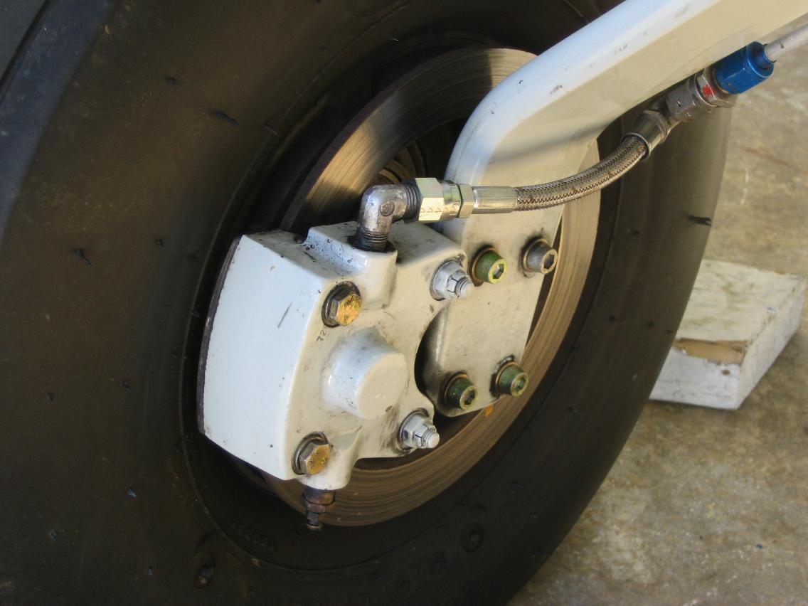

Another thing I know I'll need is to modify my brake lines. Right now they are a solid line that goes directly into the caliper. I'm thinking I can cut the line at the last elbow before the caliper then bend it down to the new position. My other idea was to cut it at the bottom of the gear and use a flex line into the caliper. Is there a preferred method? Photo attached.

Below is one idea for brake lines, my IA used to work on Dash8's and these came off somewhere on one of those....

Thanks for the photo David. That's basically what I had in mind for the brake line. Seems like that would be the most straight forward way to do it.

You CANNOT use solid lines on Cleveland brakes. (legally). The calipers are floating and need to be free to float.

Does that mean you can't use solid lines at all? Or is the short bit of flex line as pictured above ok?

Yes, all you need is a short piece of flexible line to allow the caliper to move. 12 inches or so will do fine, as long as it's got enough slack that the brake doesn't bind up. Cleveland supplies a drawing. I'll see if I can dig up a copy.

Anyone have any suggestions on where to find SS brake line as pictured in that second photo? Or better yet what is supposed to be used for the Cleveland brakes? I looked through my aircraft documentation and didn't see anything specific. I'm definitely missing some documentation here and there. Aircraft Spruce didn't have anything that looked like SS line.

The externally braided lines are not allowed. They can be near failure and not be detected early because the braid covers the rubber.
