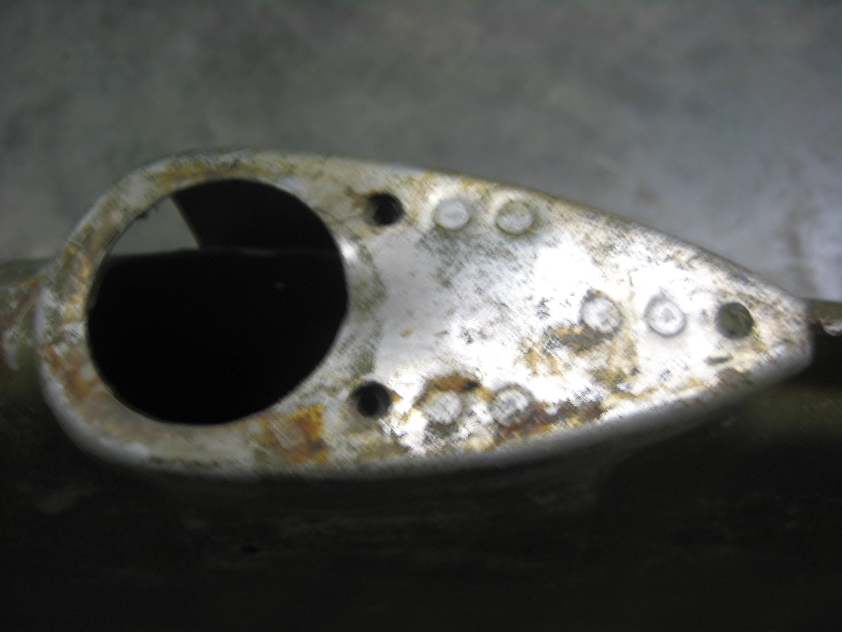

My IA was happy with”navy light replacement”. The only issue I had was the non existent tinnermans for my nav light attach points which was solved with 6 #6 rivnuts.

Steve wrote" "... non existent tinnermans".
I've looked at a few wingtips & see that some have nut plates (like this one) and others don't. Rivnuts can be great solutions.
