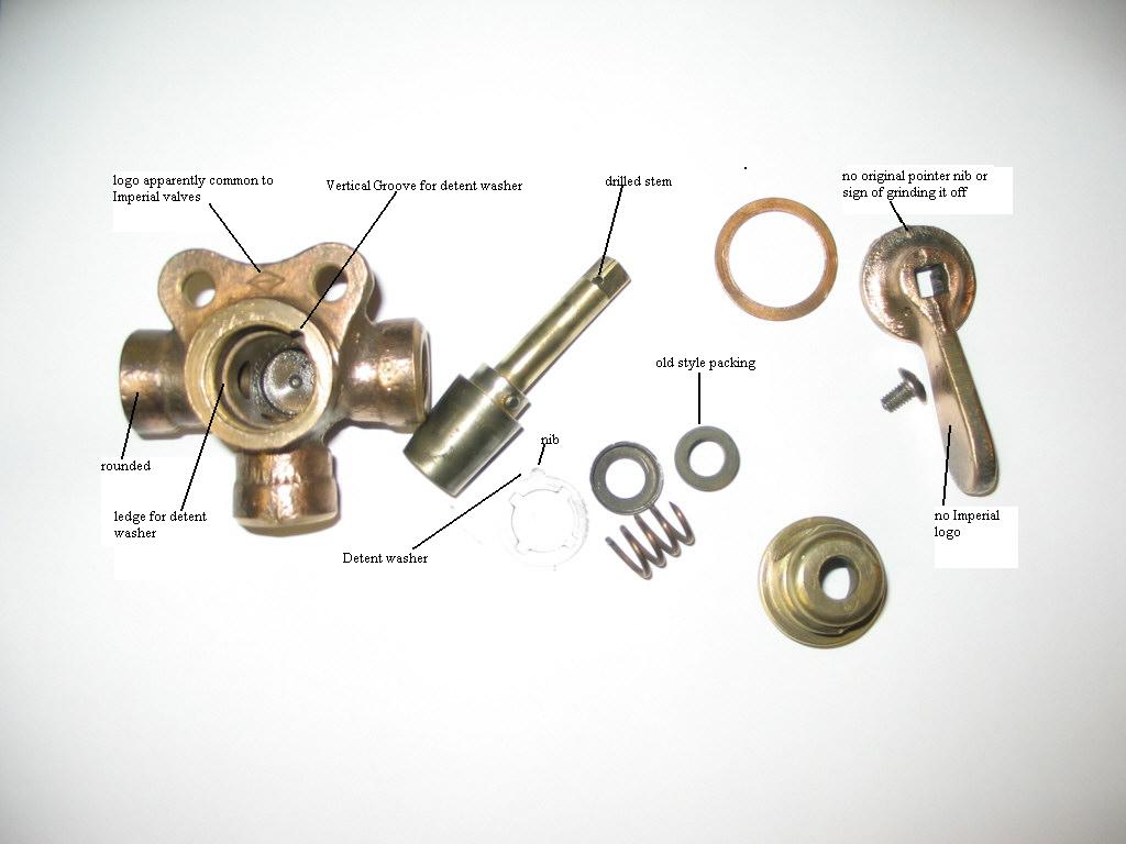

took valve apart because it was totally stuck. my valve had no packing but I guess some do,a schematic of the valve might help. I also need a plate marked left right and off,mine is not readable

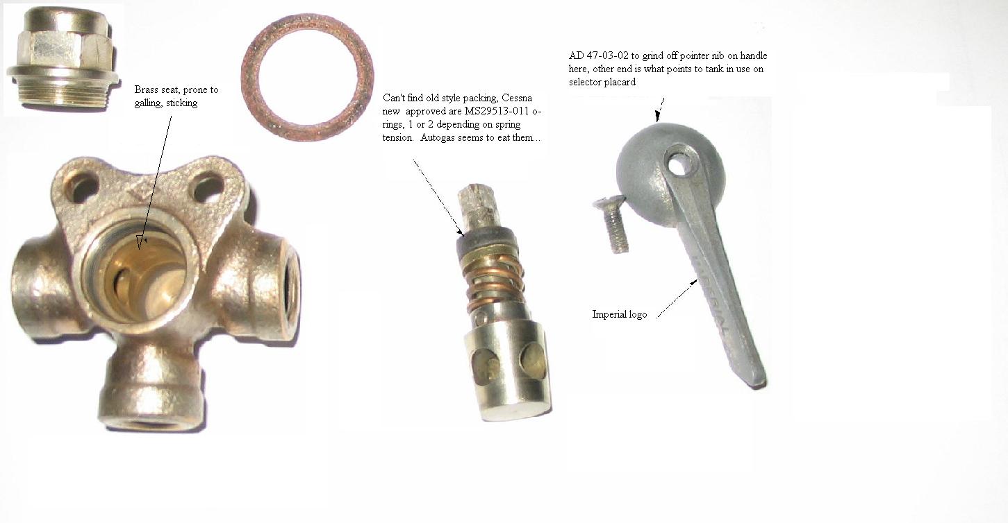

First, consult Neal Wright's excellent article on the subject: viewtopic.php?f=10&t=131
Second, here are two photos recovered from the old forum:
Third, ignore all references to Jensen parts. They proved problematic and are no longer available.
