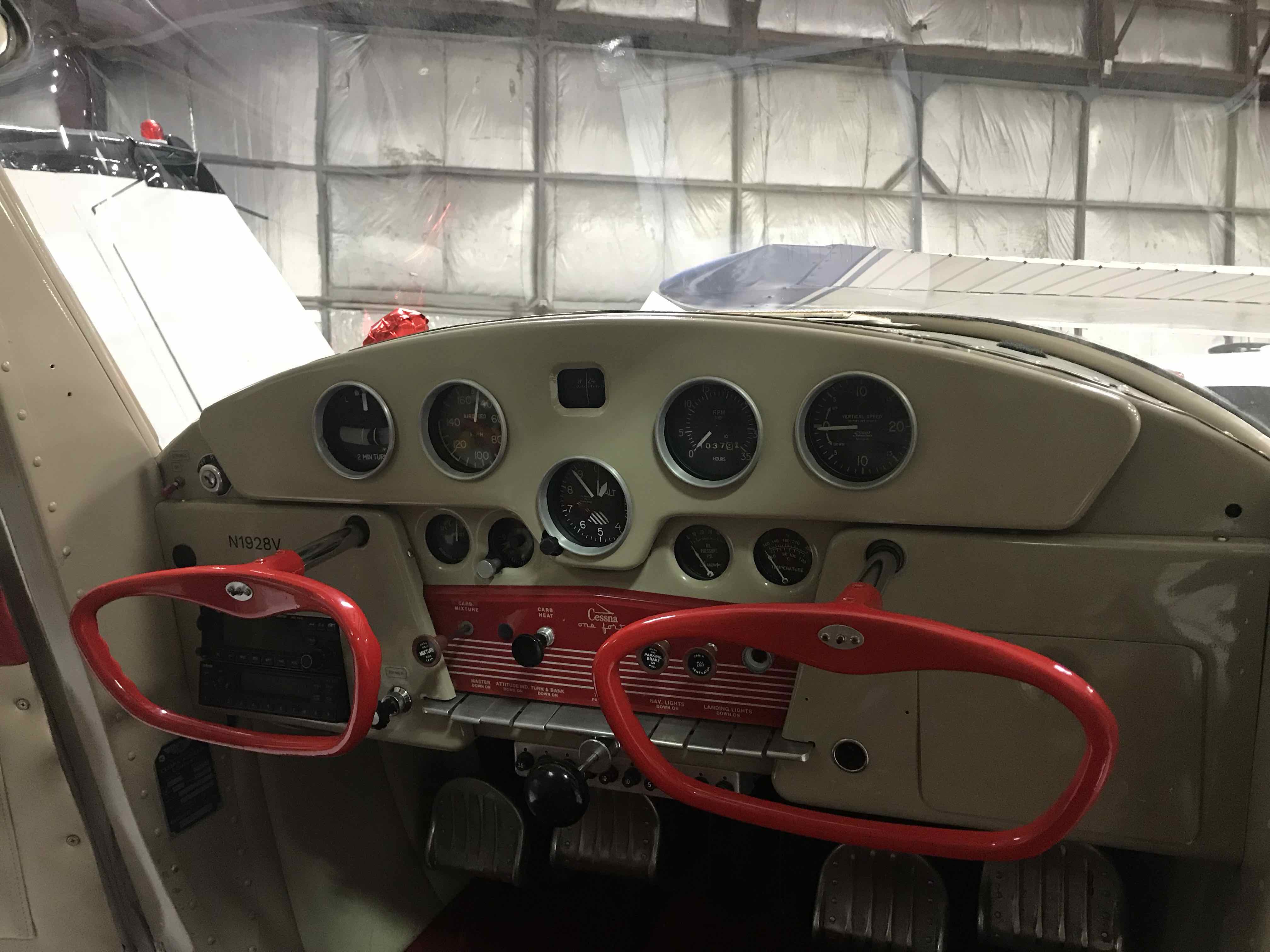

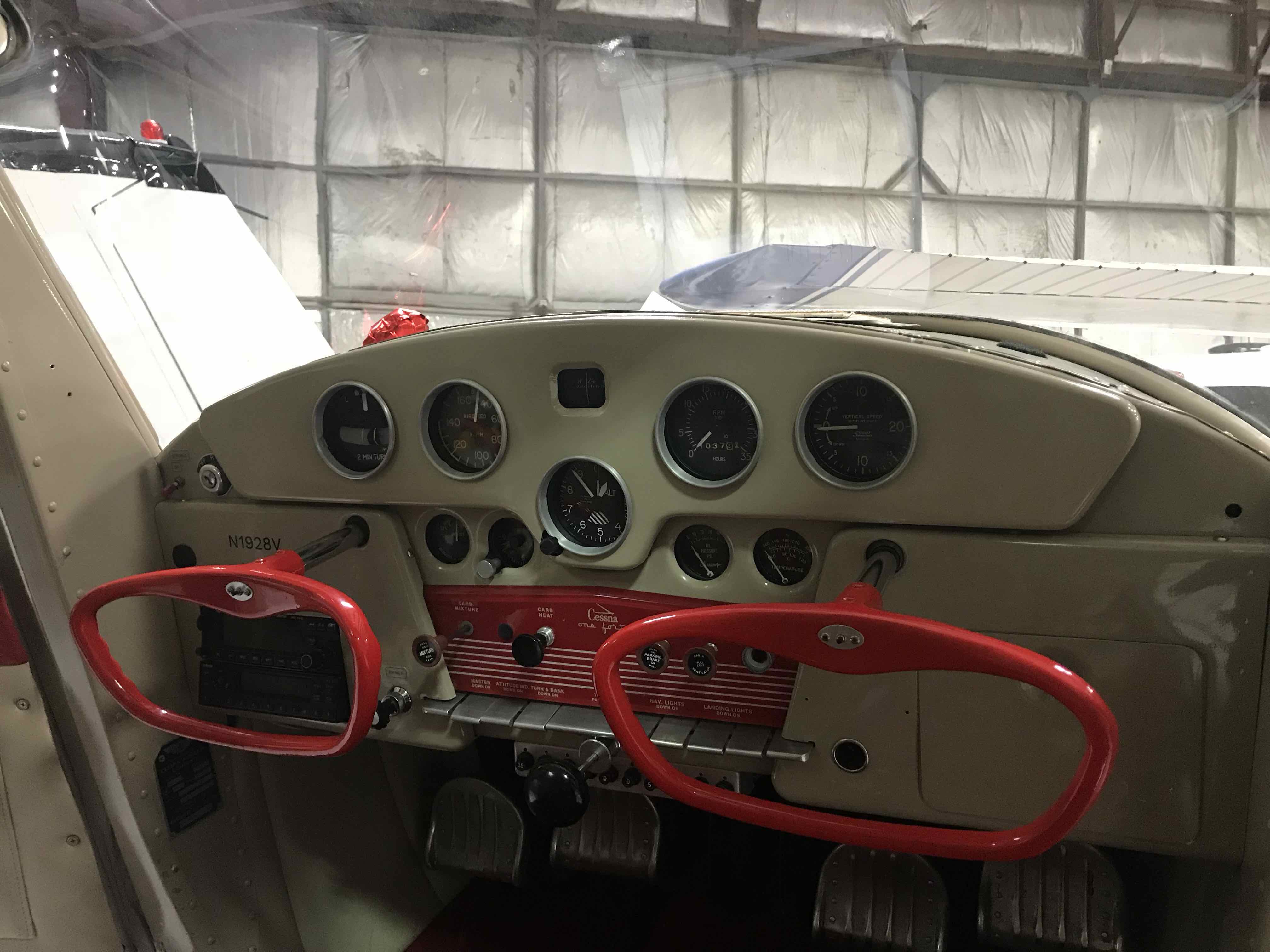

I'd like to remove my PTT buttons & coil wires, velcro'd to the yoke, and mount a button to the yoke. I've seen pics of buttons in the center and off to the side of the yoke but the wire appears to be run down the middle of the yoke tube. Other than drilling the tube I don't see another way to run the wire. Not sure I want to drill the tube. How have people installed these?

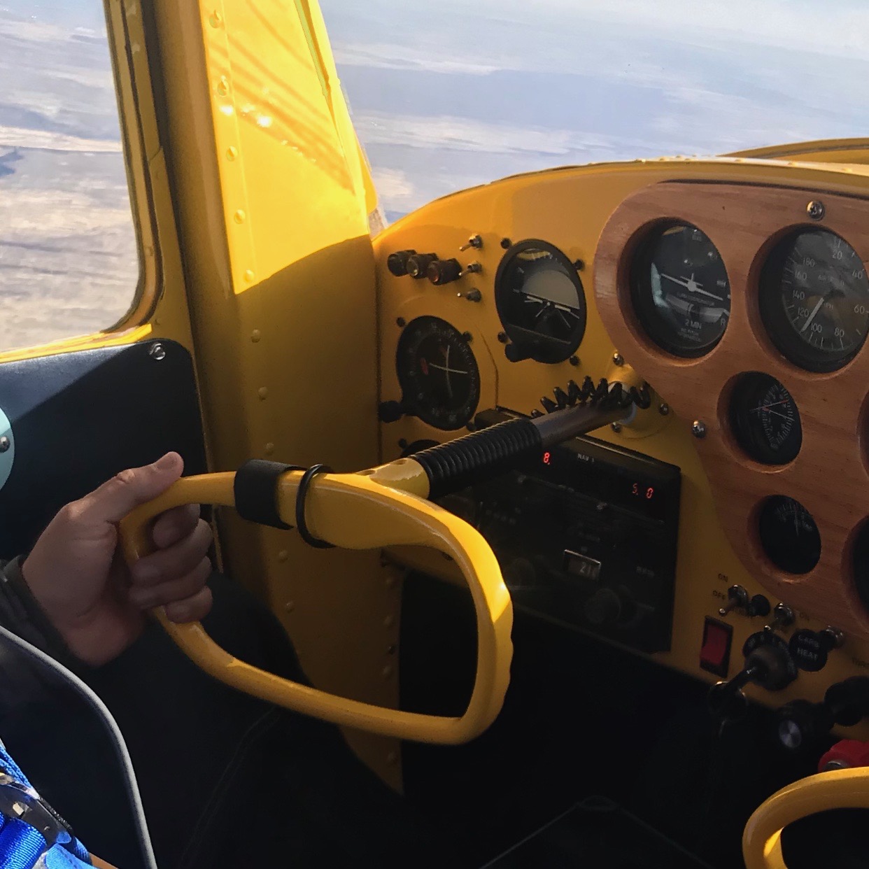

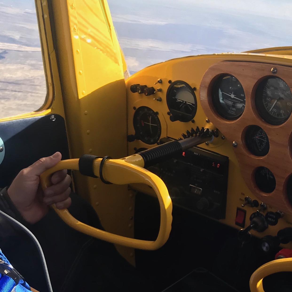

I looked into this and in the end decided to keep my velcro switches. It's a lot of work to maybe get it looking right and I didn't want to risk drilling my yokes and messing them up. I coiled mine around the yoke shaft and then back behind the panel, this keeps them from dangling all over the place. I also cut the cable and wired them directly to the radio.
