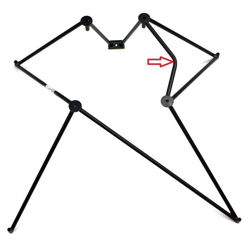

On the left side, where the engine bolts to the mount, there will be a angled pipe welded to the upper and lower attach points. As viewed from the cockpit. It had to be a C-90-14, that used lord mounts.
Re: engine mount
Posted: Thu May 17, 2018 8:31 pm
What Randy said. The C90-12 used the same mount as the C85-12. The C90-14 uses the same mount as the O200. The later mount has an extra bracing tube as Randy described.
140a mount.jpg (66.09 KiB) Viewed 9965 times
(Photo from of Univair's web site)

Is the actual difference between the mounts that added angled brace bar? Are the mount pads identical to the 140A?
Re: engine mount
Posted: Sun Jan 16, 2022 8:27 pm
by 6298
The Mount in the picture is about 3/4 of an inch closer to the firewall. With the lord mounts like the C-90-14 and the O-200’s use the cowling fits right!

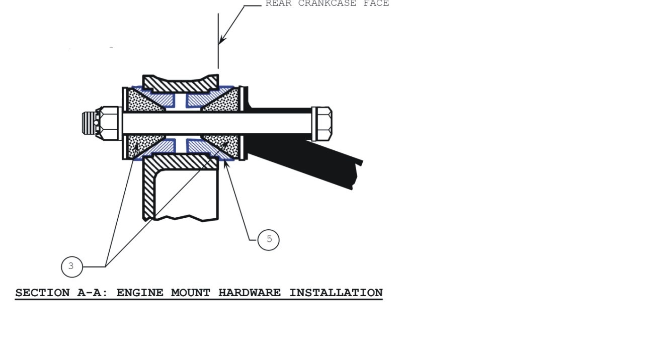

There used to be a guy who sold adapters to use the conical mount on the O-200 on E-bay, but he seems to have disappeared. He also had a web site, http://www.continentaladapter.com/ but all I get is a blank page. I know some people who have used them in the past and gotten them approved. Or, if you're handy with a lathe, you could whip up a set.
Conical adapter.jpg (74.72 KiB) Viewed 7851 times
