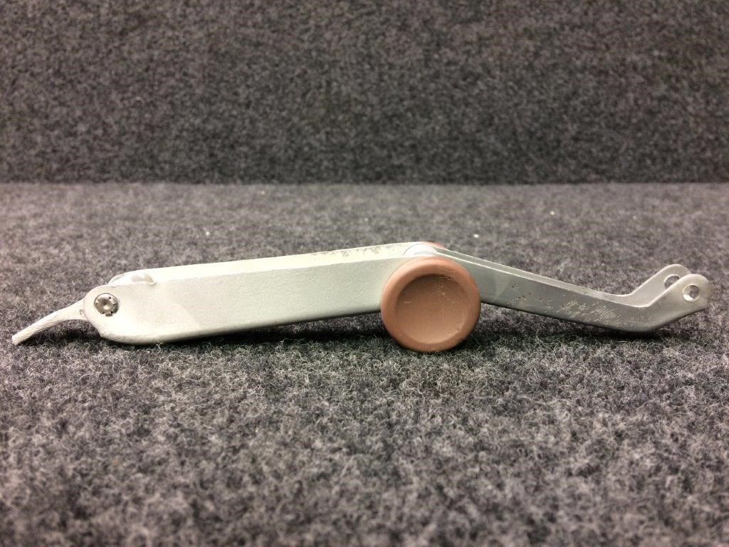

This one is on Ebay (170 section). ...a bit pricey @ the asking price of $210.00, but does suggest will take "best offer". They do show up there from time to time as Mike indicates, intact as well as parts...good to search 170 stuff as well as 140 occasionally. You're gonna have fun with this "new" 120 -- congrats! Mac

I may have a window latch I would part with a lot cheaper than $210. I am looking into making my own for my patroller doors of a different design. I will remove it and take a picture if you are interested.
