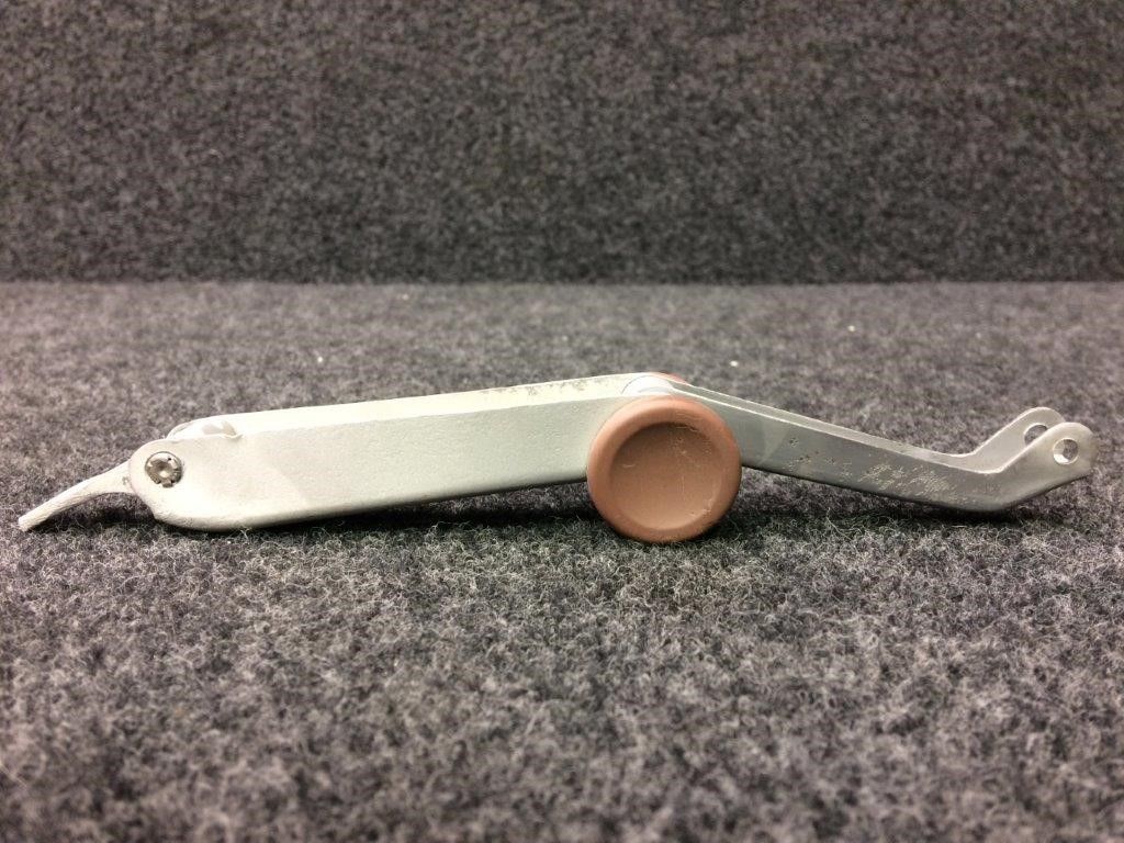

6. My pilot side window latch is broken. Is the Univair route my cheapest

6. My pilot side window latch is broken. Is the Univair route my cheapestNope, check Ebay.

6. Not seeing any on eBay right now. Maybe I am using the wrong search criteria. Assuming eBay is a bust, are there any other reasonably priced options?
WINDOW LATCH 120 140 170 EBAY 05 22 2018.jpg (145.35 KiB) Viewed 10674 times
This one is on Ebay (170 section). ...a bit pricey @ the asking price of $210.00, but does suggest will take "best offer". They do show up there from time to time as Mike indicates, intact as well as parts...good to search 170 stuff as well as 140 occasionally. You're gonna have fun with this "new" 120 -- congrats! Mac

I may have a window latch I would part with a lot cheaper than $210. I am looking into making my own for my patroller doors of a different design. I will remove it and take a picture if you are interested.
