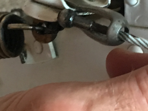

My 140 has about 1.5" of slack in the rudder cables. Is this normal?
rudder cable slack N76415 512.png (234.27 KiB) Viewed 2884 times

Check the rudder return springs at the rudder pedals.
Re: rudder cable free play
Posted: Tue Jul 02, 2019 9:03 am
Yes, the only tension on the rudder cables is from the pedal return springs. The adjustment is only to get the rudder pedals in the right place, 6" fromof the firewall.
