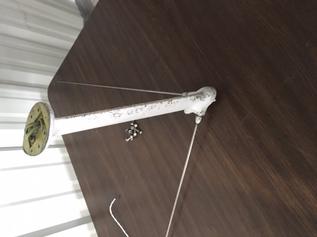

My apologies. It is the "flying V" with NARCO on both sides of the mast. I have pics, just need to figure out how to post them.

attempting to post a picture.
Narco Antenna.JPG (75.34 KiB) Viewed 6883 times

Yes that is the antenna I described (obviously). I have one in my basement and I just refreshed looking at it. I would not recommend any further disassembly of the antenna - it's a passive device but with unique electrical properties. The two cable loops protruding thru the base are segments of the "balun" I mentioned. This is special configuration of coaxial cable that matches the antenna impedance to the input impedance of the receiver ensuring maximum sensitivity and directivity. Since it becomes a sealed item there is no "wear and tear" on the internals.
Recommend you just clean the exposed metal (paint and corrosion) and prime and paint. Just scotch brite the stainless steel rods (wings) but do not paint. The original NARCO lettering was black but most over the years were painted over due to erosion/corrosion reducing the sharpness of the characters - your call.
Hope this is the info you're looking for.

Thanks for the great info, Edd. I will proceed as you recommended. I've already decided to just retighten the machine screws on the top and no further disassembly.
