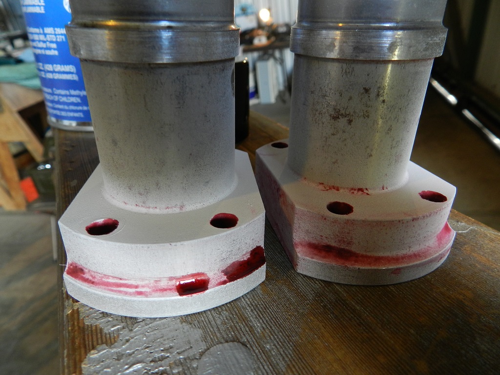

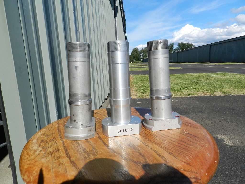

- DSCN2672.JPG (302.77 KiB) Viewed 5114 times
- DSCN2677.JPG (276.02 KiB) Viewed 5114 times

David, please highlight mer on these pictures. I have never seen before some die penetrant pictures.
Are those with all the red spots discovered cracks???

- Posts: 553
Re: hollow aluminum axles
The one on the left shows a faint trace of penetrant at the juncture of the cylinder/axle and base. The one on the right is just sloppy on my part. The base portions that have red blotches are just slop. I was specifically interested in the cylinder/axle junctures. Both axles I scrapped.

- Posts: 2775
David:
You say you rejected both axles. Were you able to confirm cracks in either of the ones pictured? The one on the left doesn't seem to exhibit a pattern indicative of a crack; it looks more like a little pitting in the radius where the axle joins the base.
- Posts: 553
John,
My IA and I waffled a bit but the dye activity we noticed on both seemed to be in essence the lower/forward areas of the axle/base interfaces, what we might expect from 70 years of landings. These were a few I found locally for 'just in case', grubbing thru a box at the old Columbia Airmotive facility. Now that you've got me curious I'll probably re-check them.
I can tell you that Groves weigh 1# 5.1oz each and the old ones I found weigh 11.9oz each FWIW.
