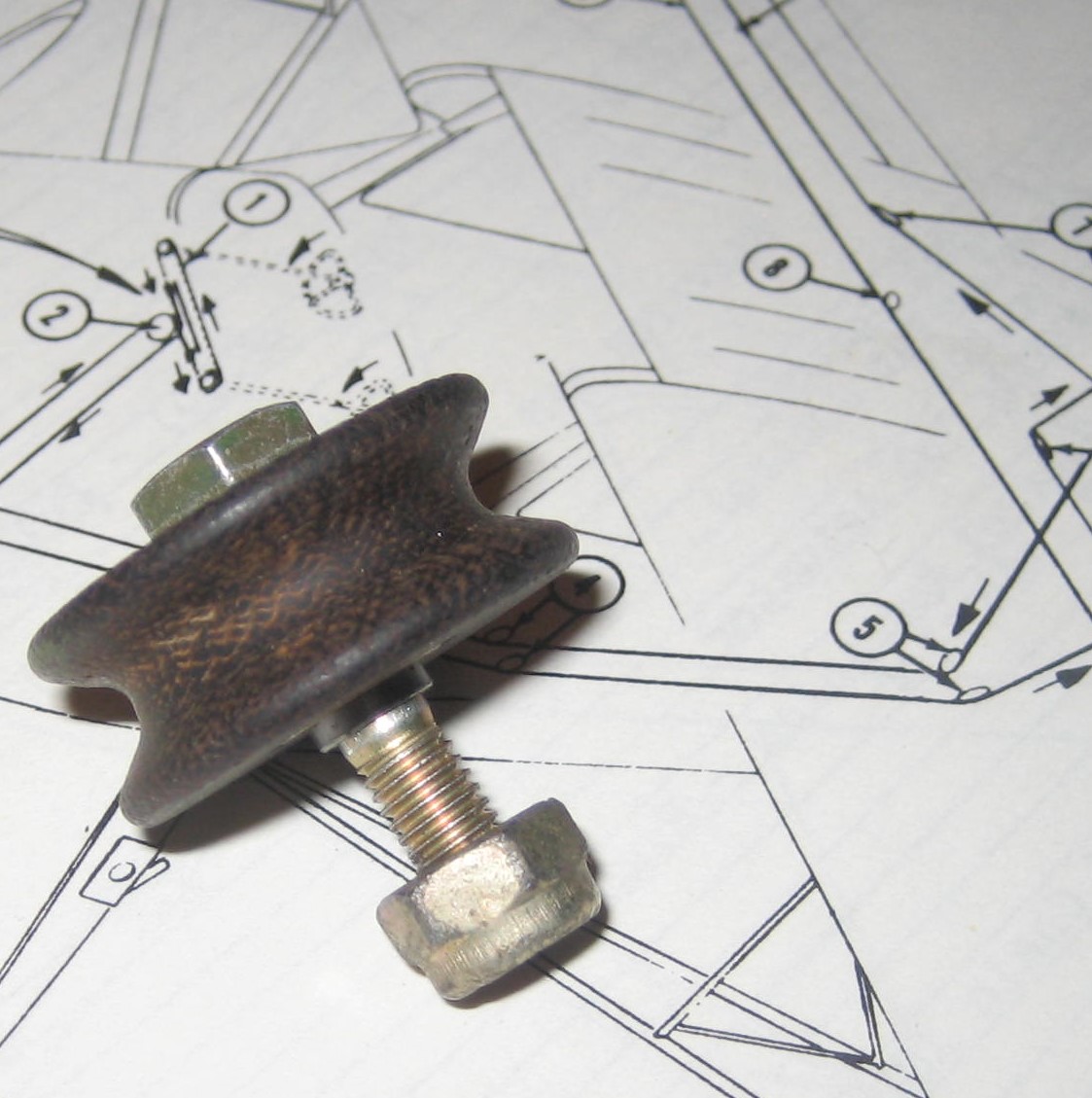

"F" is for "Formica"
Posted: Fri Jun 01, 2018 1:02 pm
If anyone needs one, shoot me a PM. New surplus, no certs.
Posted: Fri Jun 01, 2018 1:08 pm
second photo...

OK, I have in hand 58 of these babies. They're NOS, surplus. I have a friend who spends his waking hours pouring through aviation auctions and close outs. He sent them to me for next to zip. (He has 1000 of them).
I don't want to turn this thread into a commercial venture, but if you need one (there is only one used, on the rear of the carry through spar, supporting the aileron carry through cable) I'll be glad to send it along for not much more than the postage. Drop me a Private message.
