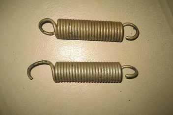

Another vote for the rudder return spring. Happened to me on the first day of a 3 day trip from Illinois to Oregon (ugh). If you need right rudder pressure to fly straight, it is the right rudder return spring that is broken which is located on the left side (pilot side).
You can check this on the ground very easily. The rudder should be roughly aligned with the tailwheel. If not, barring any other control cable issues, it is the return spring. Replacing the spring is easy once you get the tunnel cover out. I forget if you have to take the floor pan cover out too.
They are available from Univar. The right rudder spring is staggeringly expensive....three times the price of the left spring. Go figure.
