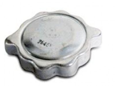

Re: Does anyone know if you can buy new fuel caps for a 1948 c140
These fit nicely. I haven’t drilled another hole yet, but. it will be easy. Part number is 05-01058 from Aircraft Spruce. Picture is too large..
Randy Thompson A&P IA Pilot
Overhaul small Continentals
- Posts: 2775
Here's the picture:
