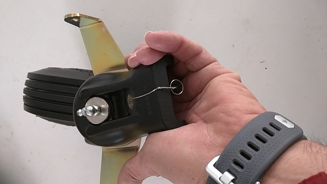

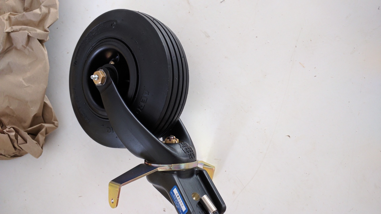

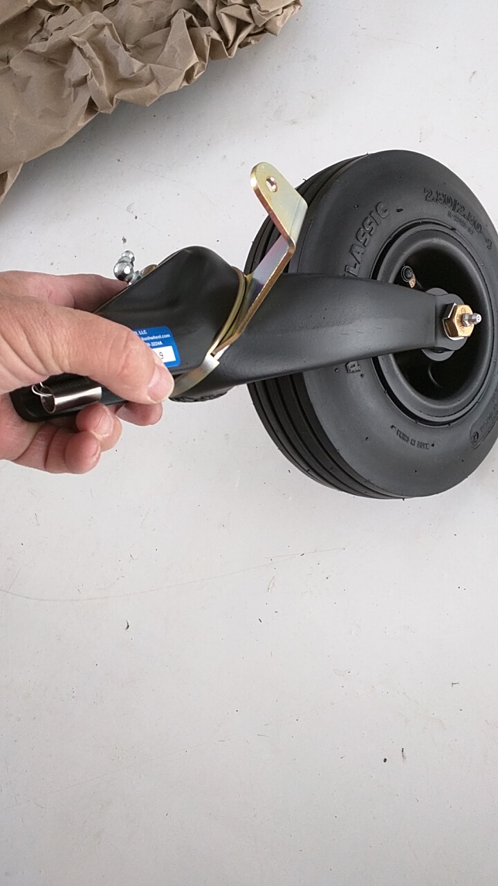

Aviation goodness delivered today! I hope to have the entire "little wheel end" reassembled by this weekend.
I like the beefier steering arm on this!
