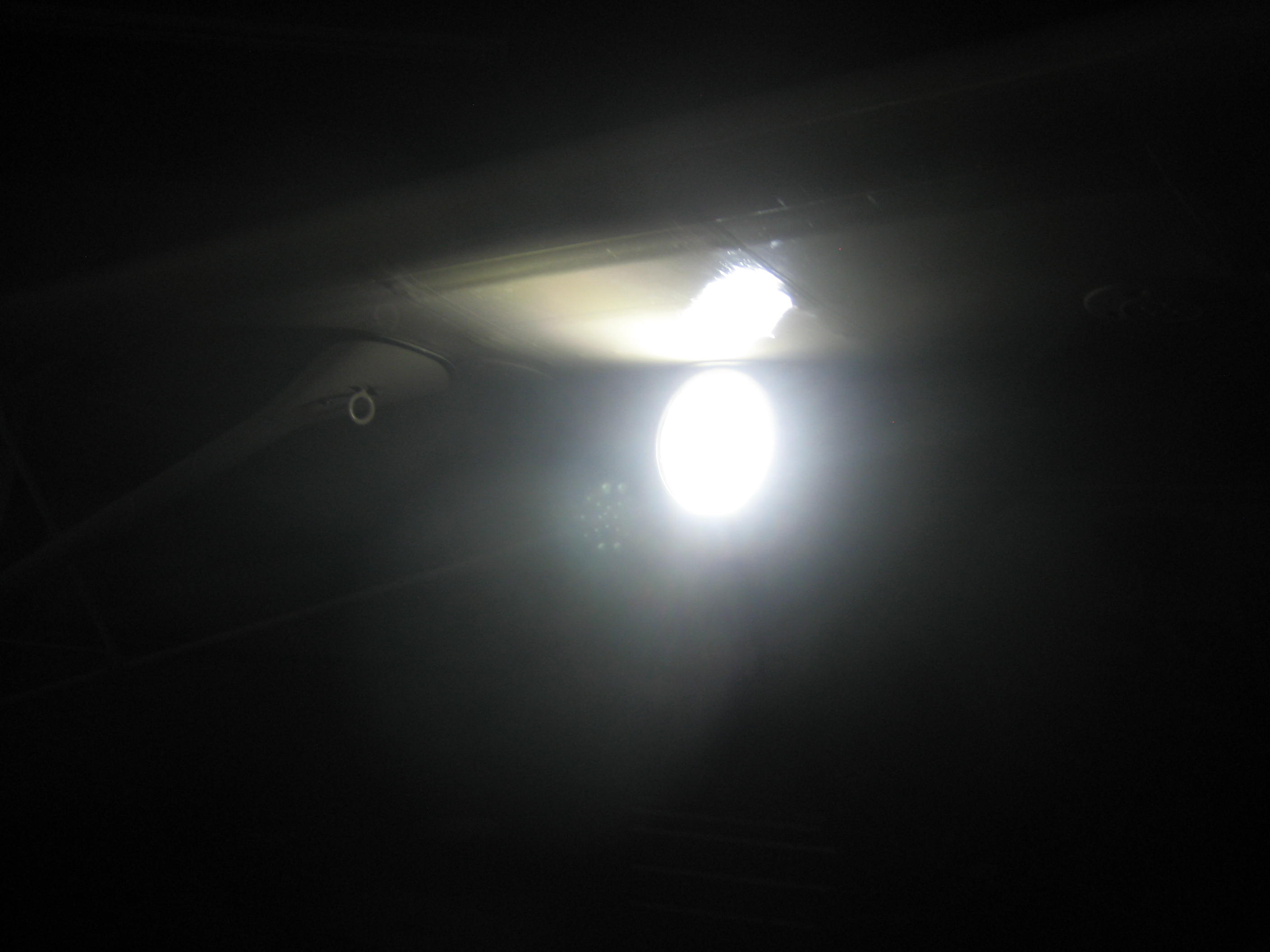

Agree, David -- good company & product line. I recently installed their bulb in my retractable landing light -- super bright & pulls only 3.65 amps. I'm now 100% LEDs, incidentally, & my little 12A B & C alternator says "I have amps to spare!"8233 wrote: ↑Mon Nov 04, 2019 10:23 pm I've really liked these:
https://www.aero-lites.com/product-page ... placements
