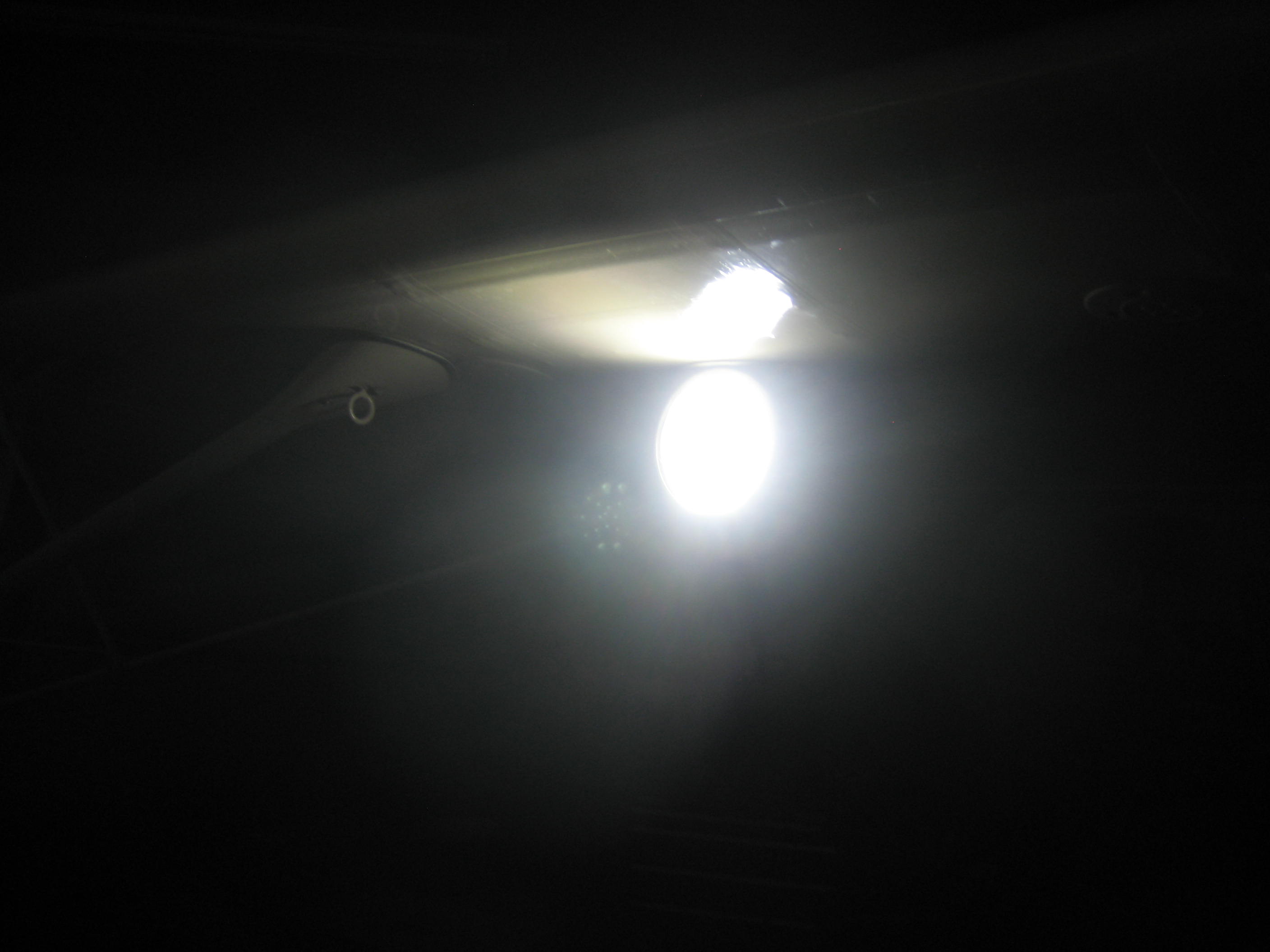

I went with these for the wings and tail awhile back, took an infrared thermometer to them and they hardly registered as opposed to the incandescents I took out. Was working on adjusting the old vibrating voltage regulator and these got me in the charging range I wanted. Very pleased and impressed. I would say at least 3 times brighter than the old incandescents and no radio interference whatsoever fwiw.

I have something similar installed on mine as the ones posted above.
They work great, very bright, almost no load and they don't induce any weird noise in the headset.
