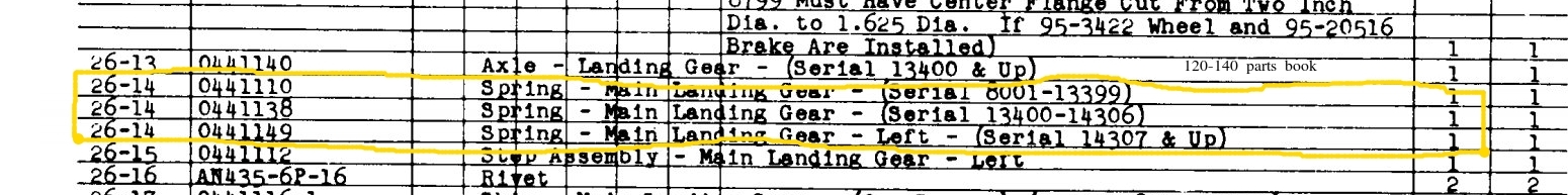

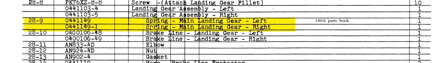

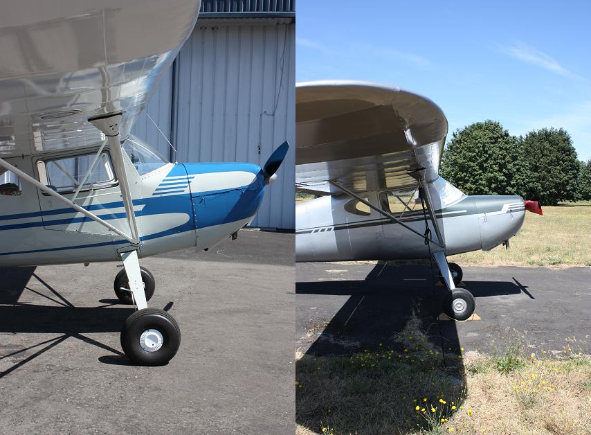

Someone else can jump in, but I think there were 3 iterations of the gear legs, the first 2 being interchangeable left and right, and the last having a 'bend' to mimic the extenders and thus a 'left' and 'right'. How you would determine the 'bend' (or 'twist' in Neal's article) I don't know. Here's a pic of my bird with another bird, showing the gear legs in profile on the plane. The first shows the 'straight' legs, the second shows the 'forward bend' legs. Use the wing struts to see the difference. Hopefully someone has some more useful information for you.
I'm certain the first iteration had the 1/4" axle bolt holes.

According to the parts lists David shows, the specific left gear ('bent gear'), part #0441149, started with C120/C140 serial #14307.
The following Cessna document indicates serial #14307 was toward the end of the 1947 serial number group.
https://support.cessna.com/custsupt/con ... s_id=23391
My 1949 C140, serial 14913, had the 'bent' gear.
Hope this helps.
Steve H

PN 0441110 Straight, symmetrical about the center line, fits left or right, 1/4" axle bolt holes. Up to sn 13399
PN 0441138 Straight, symmetrical about the center line, fits left or right, 5/16" axle bolt holes. Sn 13400-14306
PN 0441149 Angled, not symmetrical, 5/16" axle bolt holes, fits left, sn 14307 -> and all 140a
PN 0441149-1 Angled, not symmetrical, 5/16" axle bolt holes, fits right, sn 14307 -> and all 140a

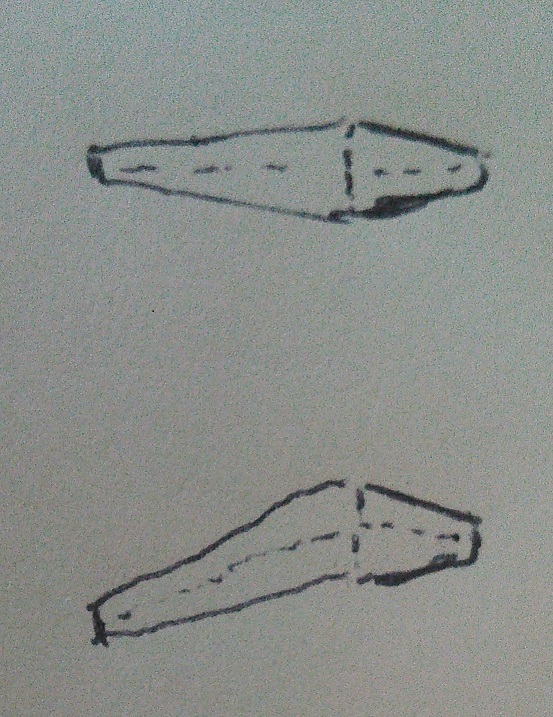

No. If you draw a line from the center top of the leg (where it fits into the gear box) down along the face of the leg to the center bottom, where the axle attaches, and you keep the line mid way between the edges of the leg (a "center line"), the straight gear will be symmetrical about this line and the swept gear will not be.
