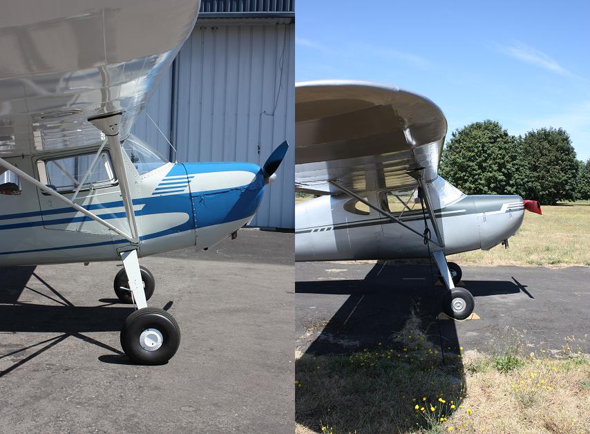

Someone else can jump in, but I think there were 3 iterations of the gear legs, the first 2 being interchangeable left and right, and the last having a 'bend' to mimic the extenders and thus a 'left' and 'right'. How you would determine the 'bend' (or 'twist' in Neal's article) I don't know. Here's a pic of my bird with another bird, showing the gear legs in profile on the plane. The first shows the 'straight' legs, the second shows the 'forward bend' legs. Use the wing struts to see the difference. Hopefully someone has some more useful information for you.
I'm certain the first iteration had the 1/4" axle bolt holes.

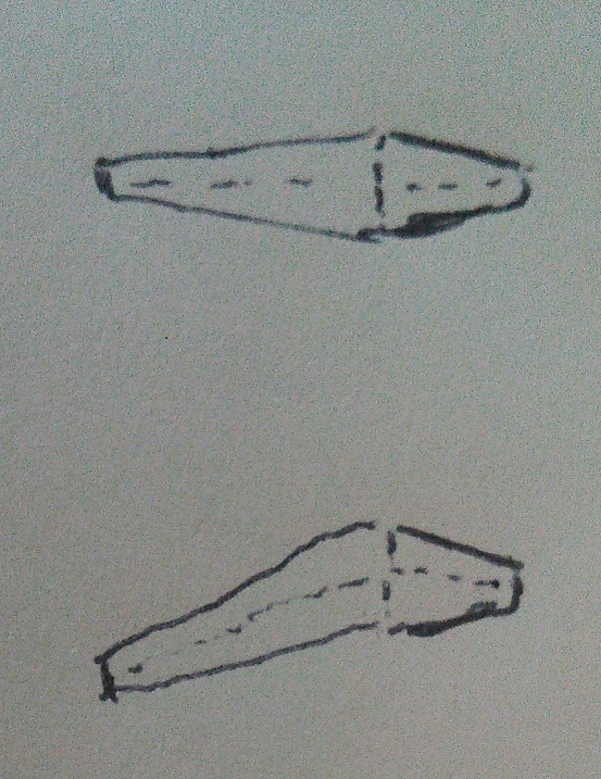

8024 wrote: ↑Fri Jan 10, 2020 9:18 amJohn-by not symmetrical you mean that the gear leg "taper" is not the same reduction in "width" going down towards the bottom of the gear leg?
No. If you draw a line from the center top of the leg (where it fits into the gear box) down along the face of the leg to the center bottom, where the axle attaches, and you keep the line mid way between the edges of the leg (a "center line"), the straight gear will be symmetrical about this line and the swept gear will not be.
Not to scale...
Not to scale...
gear legs.jpg (189.45 KiB) Viewed 35279 times
