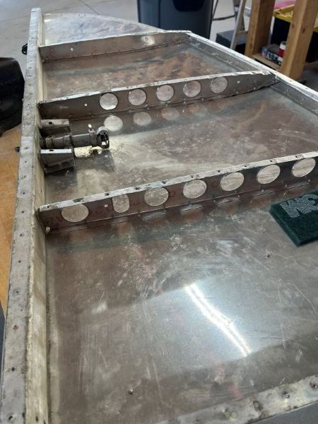

Edidin - Yes! I got the skins off. and although the corrosion was primarily on the skin,
The Corrosion migrated into two or three of the ribs.
The channel joining the spars is badly corroded.
The bent rib damage very minor.
The leading edge had a piece of rubber channel on it that was hiding a lot of nasty dents.
A local 140 owner donated another H Stab and after taking the skins off it seems I have enough ribs and non corroded spars to build another one.

Corroded skins removed.

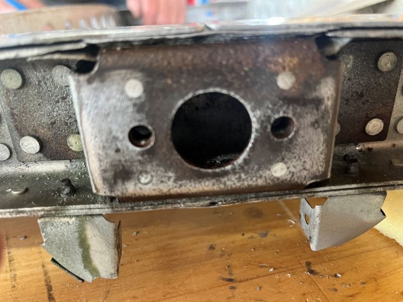

Bracket pitted but channel joining spars badly corroded
corroded channel.jpg (88.3 KiB) Viewed 42215 times

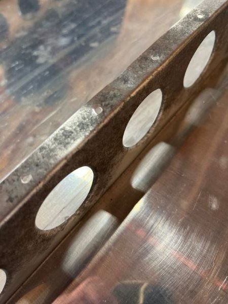

Rib corrosion although rivets were in good condition.

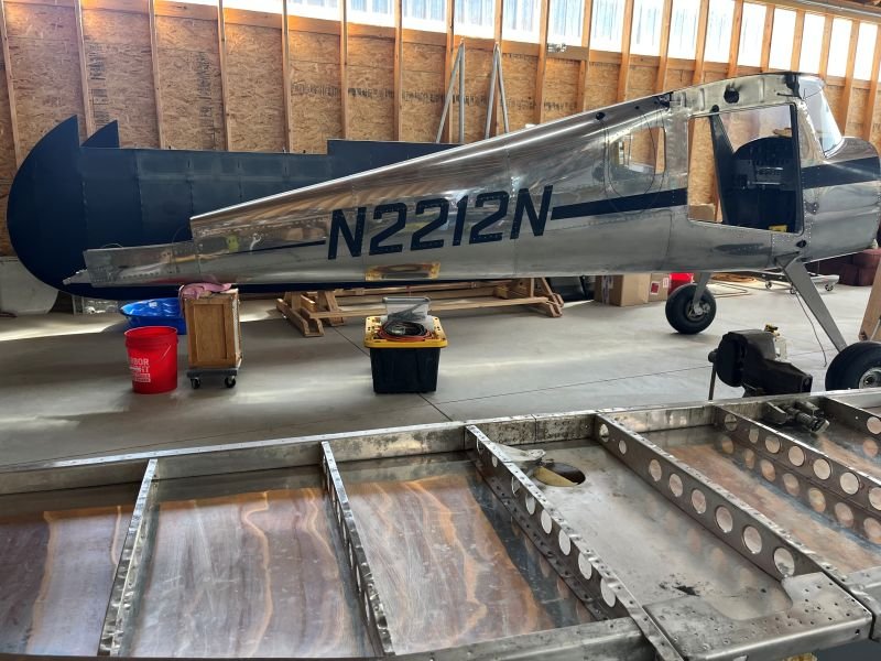

8475/Dave Sir! - Thank you for helping me understand the legalities and specific FAA rules. I'm having better luck with my mechanic now that he is getting to know the care in which I've been disassembling these two stabs. On the one hand I'm looking forward to the challenge of rebuilding a like-new horizontal stabilizer, on the other hand a couple people now have reached out with potential used H-stabilizers. This would save time for sure!
The fuselage is in much better condition than the coastal Alaska H-Stab.  I'd lie to come up with a stb. in as good of condition as the rest of the ol' girl!
H Stb Fuselage Wings.jpg (108.3 KiB) Viewed 42209 times
