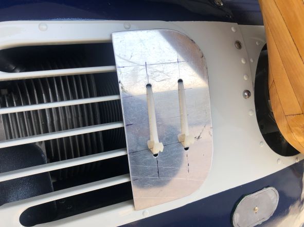

I made covers for the four openings in the cowl similar to the plans described above, except I hold them on with cable ties. I used a hardware store cap to plug the inlet to the oil cooler blast tube. All that gives me sufficient oil temperature.
As to those fabric covers for the oil tank and intake tubes - I never put them on because I didn't need them in our climate (upstate NY). Also, it seems to me they would be magnets for oil and grime. Maybe needed in really cold climates. When it's that cold I stay home by the fire................!

My plates - later I prettied them up and painted. Rubber sheeting glued to back sides to protect paint. Painted black with black cable ties they are pretty much invisible.
