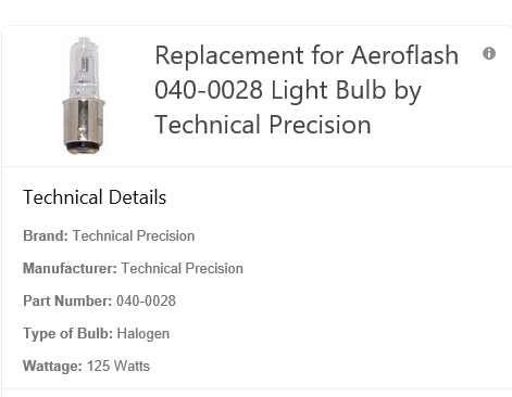

I am searching for a beacon flasher for my '46 120. It has an Aeroflash bulb and only flashes it's NOT a rotating beacon. It was missing from my plane when I purchased it a year ago and I'm about ready for the first inspection/annual since it's last log book entry in 2006. I'm not sure what it's even supposed to look like and the one's on eBay look like a heat sink...

Is it a bulb or a flash tube? A picture might help.
AEROFLASH BULB.PNG (25.18 KiB) Viewed 9666 times

What you have is probably the old AEROFLASH system that used a bulb, no strobe, and a flasher and was mounted on the vertical fin of Cessnas for years. An inexpensive way of meeting required beacon spec, simpler installation, etc.
Check Spruce for P/N 156-0003, AEROFLASH flasher and associated verbiage - looks like you may upgrade to a double flash.

I can't seem to find a flasher for this bulb that can handle 125 watts. Does anyone offer an LED bulb that can be hardwired to my 12 volt system without a separate flashing unit or something fair priced that will work? I actually bought a Cessna flashing unit from eBay but it seems to be for position lights that are way less wattage. It says it can only handle 3 watts max..... back on eBay it will go along with the Aeroflash $50 bulb.....

Posted: Thu Nov 12, 2020 7:55 pm
