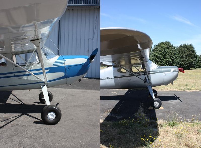

Here's a pic of a straight leg (my bird) on the left and a swept forward gear on the right, use the strut for reference to see which you have.
- sweep.JPG (113.91 KiB) Viewed 134176 times
