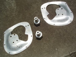

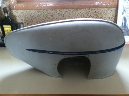

- Posts: 2828
Re: Wheel Pant Bracket
Maybe I'm missing something here, but the opening in the 140 wheel pant is almost round whereas that plate appears to be much more of an oval or rectangular shape. Looks like it might fit a 150 pant, but I can't see how it would fit one from a 140.
Additionally, mounting a 140 pant on a flat plate will stress the pant because the opening doesn't sit in the same plane as the axle mount, hence the compound curve.
