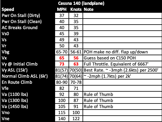

Here is the values that I'll be using on my C140:
I was studying my POH & I'm a little bit confuse with the ''Best Rate of Climb'' speed & I didn't found the Best Angle of Climb.
Questions:
1. There is the Vy that we should use at initial climb (73 mph) & the Vy at sea level (81 mph). Why there is a big difference like this.
2. What value are you using for Vx.
- REF_USE_ONLY_C140_V_Speed.xlsx
- (9.71 KiB) Downloaded 606 times
- 24372293-fe847e5e0f2b211e91bc1ba54a88944c.png (67.95 KiB) Viewed 8492 times

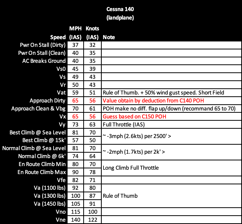

I have been updated my personal spreadsheet for reference.
- (11.43 KiB) Downloaded 702 times
- 24423510-be10c220d6206be2811e3bbd1213f647.png (152.38 KiB) Viewed 8434 times

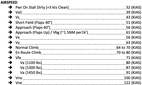

Totally agree! Even on my AC it can change from day to day based on the Configuration & the Environment. I was just looking for other references to compare with my calculations.
Here is my airspeed (in knots)... same values as my last post for those who are commonly using mph.
*I also did a checklist & it's available in another thread : viewtopic.php?f=6&t=642&p=11776#p11776
I'll test these values this summer when I'll be done with my mini-restoration.
- 24546033-0c010657ce6314e8906792928f3146cc.png (25.54 KiB) Viewed 8336 times
