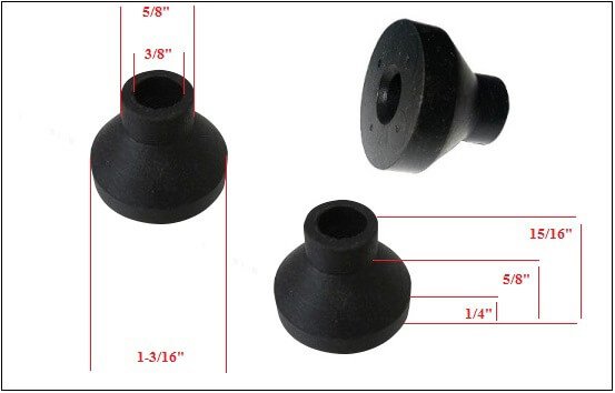

Hi All,
The rubber engine mount bushings (Continental part # 2387) have deteriorated and I have new bushings on order from spruce. The C-90 mount has a sleeve in the bushing that stop the compression at a defined spot. The C-85 bushing does not and, I suspect, you could squeeze the poop out of them long before you'd reach a torque value. So... how tight do I tighten the mounting bolts on a C-85?

There are two styles of mount, often called "conical" an "Lord" mounts. The mounts shown above are Conical mounts and fit all C85 and C90 engines except the -14 (e.g. C90-14) variants. The Lord mounts fit the C85-14, C90-14 and all O200 engines. (The Continental overhaul manual says the -16 variants also use the Lord mounts, but I have found that to not (always) be true.) The lord mounts are made up of 8 pieces, including a steel tube that runs through the center. The steel spacer is inside a rubber bushing (another one of the 8 parts) in the photo.
. To add to the confusion, Cessna lists a steel spacer that runs through the center of the conical mounts. Continental does not, and more than one person has mentioned problems using them since there is no provision in the conical cushion for a spacer between the cushion and the bolt.
Here's the Continental drawing, including the torque spec (60-80 in-lbs.):
. The Cessna part number for the steel bushing is 0450195. This is not the same spacer as used in the Lord mount, which is 0450200-502.
