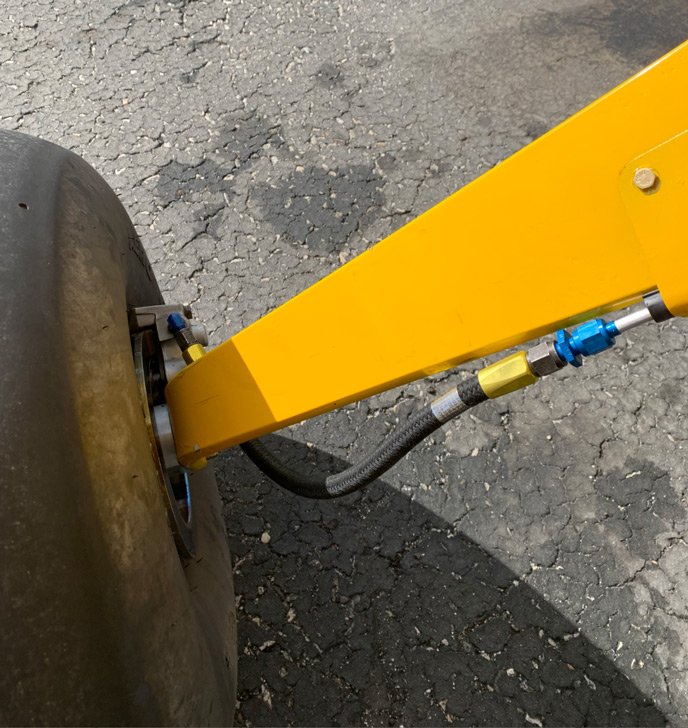

Thanks, Vic and Art. That's exactly what I meant. Now the hose can flex in several different directions as opposed to a straight hose that has to change length to move side to side without describing an arc. I took a picture of mine, but it's not a good example as my brakes are on the aft side of the wheel. (I know... They've always been that way...)

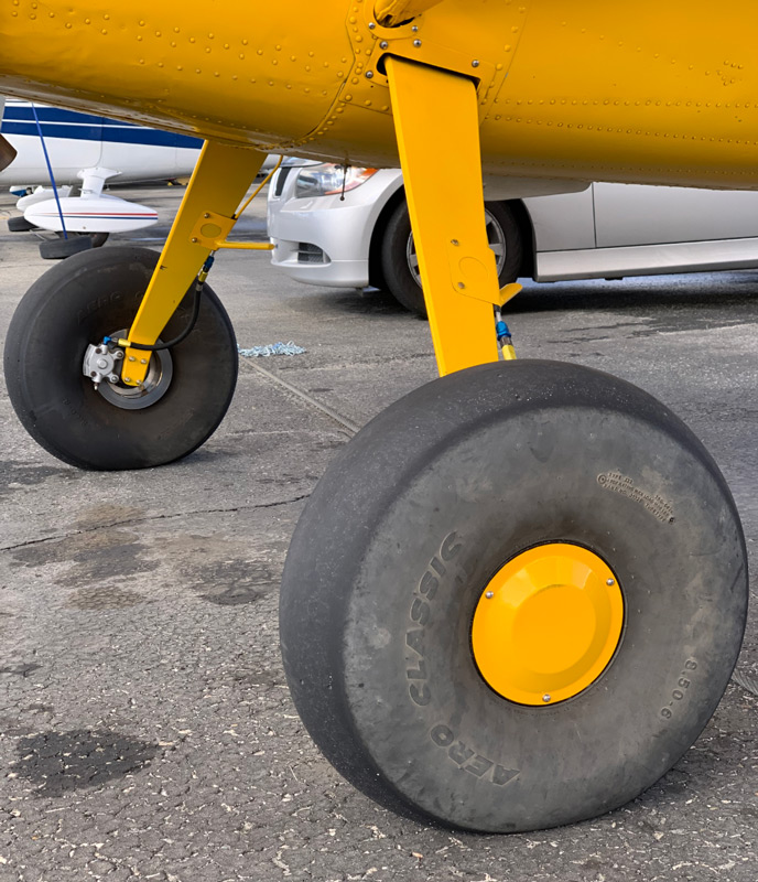

Finally got my axles from Grove, and finally got around to this project. I have to say it was a lot easier than I was expecting, but also had a few curve balls.
I ended up having to rebuild both calipers and the right side master cylinder. I'm glad I did though as they were both pretty dirty/gunky. The braking system is surprisingly simple and easy to work on. After rebuilding I also installed new brake lining and rotors. With a clean braking system it was very easy to bleed the brakes from the caliper. I just pressurized it with a little bottle and filled the system up to the masters.
I did a test flight today and everything was great. I did a few high speed taxis first to get a feel for it and break in the new brakes. The tail comes up much faster now, and the short field performance improved with the little bit of added AoA. Even with the O-290-D up front, I never felt in danger of burying the nose into the ground, yes it's a little more sensitive, but still very controllable.
Thanks everyone for the help on this project, it made it very easy. If anyone else wants to tackle this and has any questions feel free to ask!
I do have one question here, what are you guys using to tie the line to the gear leg? There isn't enough space to use a clamp, I noticed some of you had a piece of hose and a zip tie?

Great looking install. Take another look at my picture, that's a home made strip of very thin steel with a rubber liner bonded on the inside. mated with an Adel clamp. Works like a champ!
I suppose a tye wrap would work.........however, as odd as it sounds, tye wraps can dig into steel and definitely aluminum, so be wary. You'll want to support the line and union with more than the landing gear step location, eventually that hard line will break right there. (watch how much your landing gear legs flex on bumpy runways, or runways with dips!)

Thanks Victor, I’ll give that a shot, looks straight forward enough.
I’m very happy with how it turned out. I probably could have gone 1-2” shorter on the aeroquip hose, Which would have given me a little more solid line below the leg. But it think this will be fine.
Thanks again for the help.

8359 wrote: Sun Dec 01, 2019 8:42 pmI probably could have gone 1-2” shorter on the aeroquip hose, Which would have given me a little more solid line below the leg.
I would go the other direction. It's that stub of unsupported hardline that might break, and shortening it as much as possible would reduce the likelihood of that happening.
My brakes are on the back side, but otherwise like yours. There's nothing supporting the lines below the step, and it's been that way for at least 30 years.
