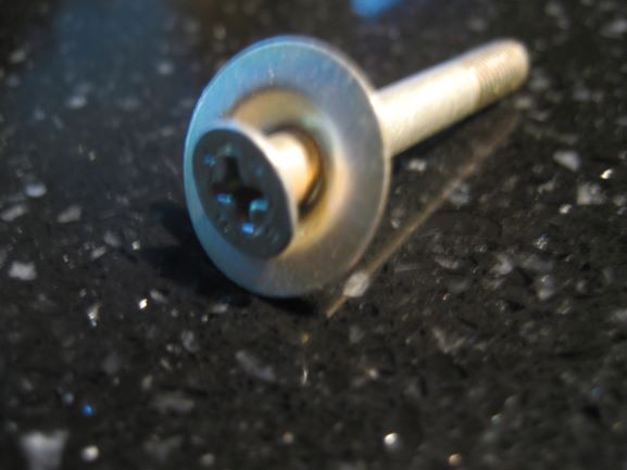

Re: NAS 205 Screw source
This'll work:
Mac
A 100 degree SS CSK washer, carefully "machined" down to fit the screw head & hinge countersink...fit/shim depth is "perfect". While I can't guarantee that it's acceptable in every case, I know at least one IA who saw it as "minor". It's easy (...well, relatively) to file the outer edge off the washer to the point that it fits both screw head & hinge countersink.. FWIW, this "repair" has been known to last for 20+ years with no indication of wear. (Yikes...this one needs cleaning up just a bit!)
Mac
- Posts: 2826
That's called a "Tinnerman Washer" and it's perfect for the purpose! you will have to cut it down flush, though, or it may catch on the rib.
