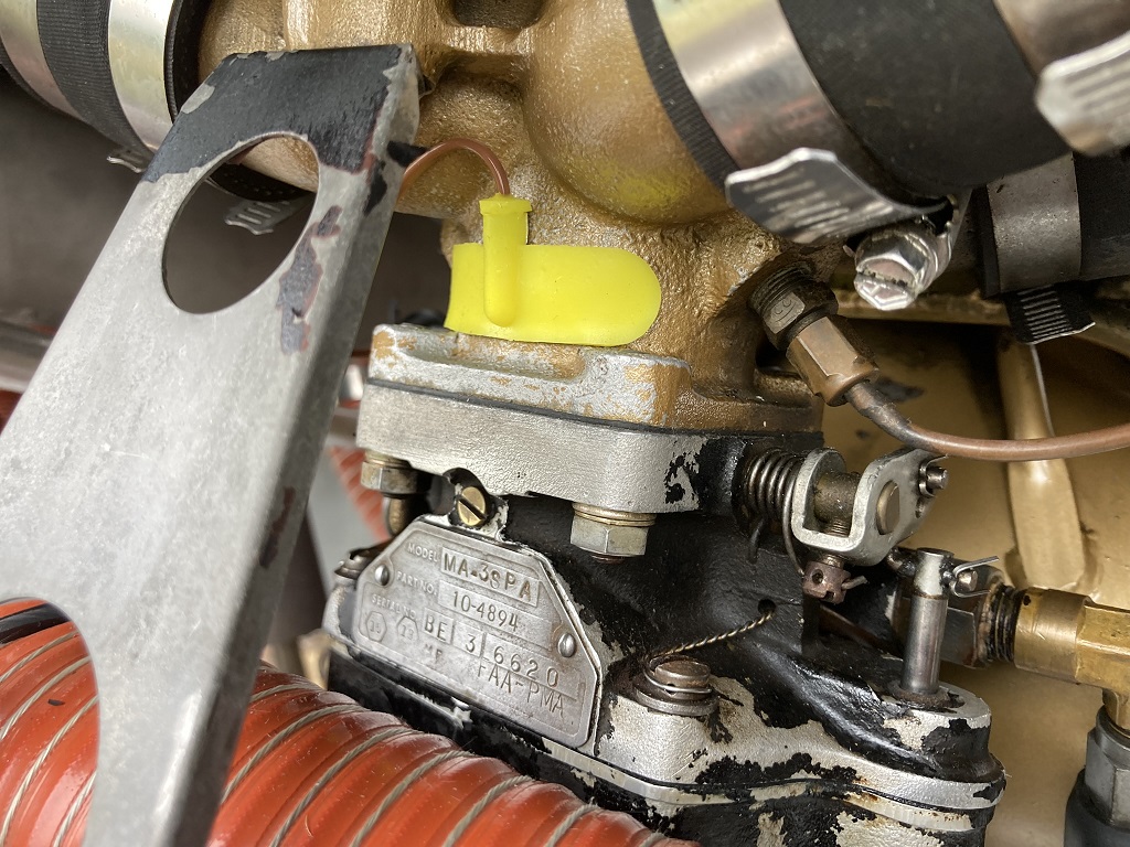

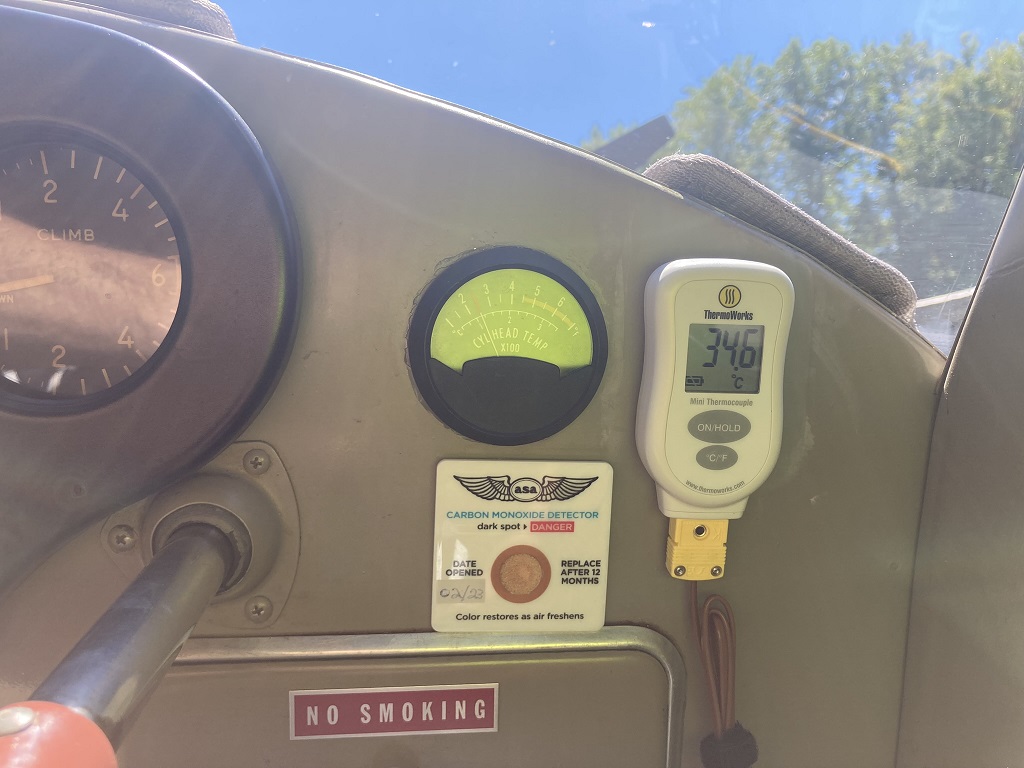

You can make a simple carb temp probe from the following items:
Omega: SMPW-K-M & SA2C-K-72
Thermoworks: MTC mini thermocouple meter
I've found it interesting to watch the temperature rise when I apply carb heat. Also, now I know when the manifold is approaching the freezing zone.
Cheers!
