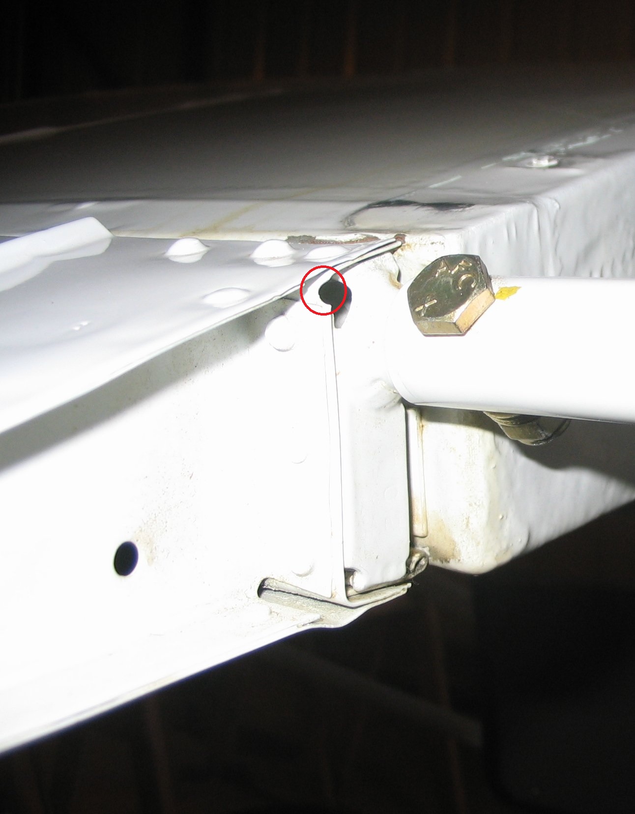

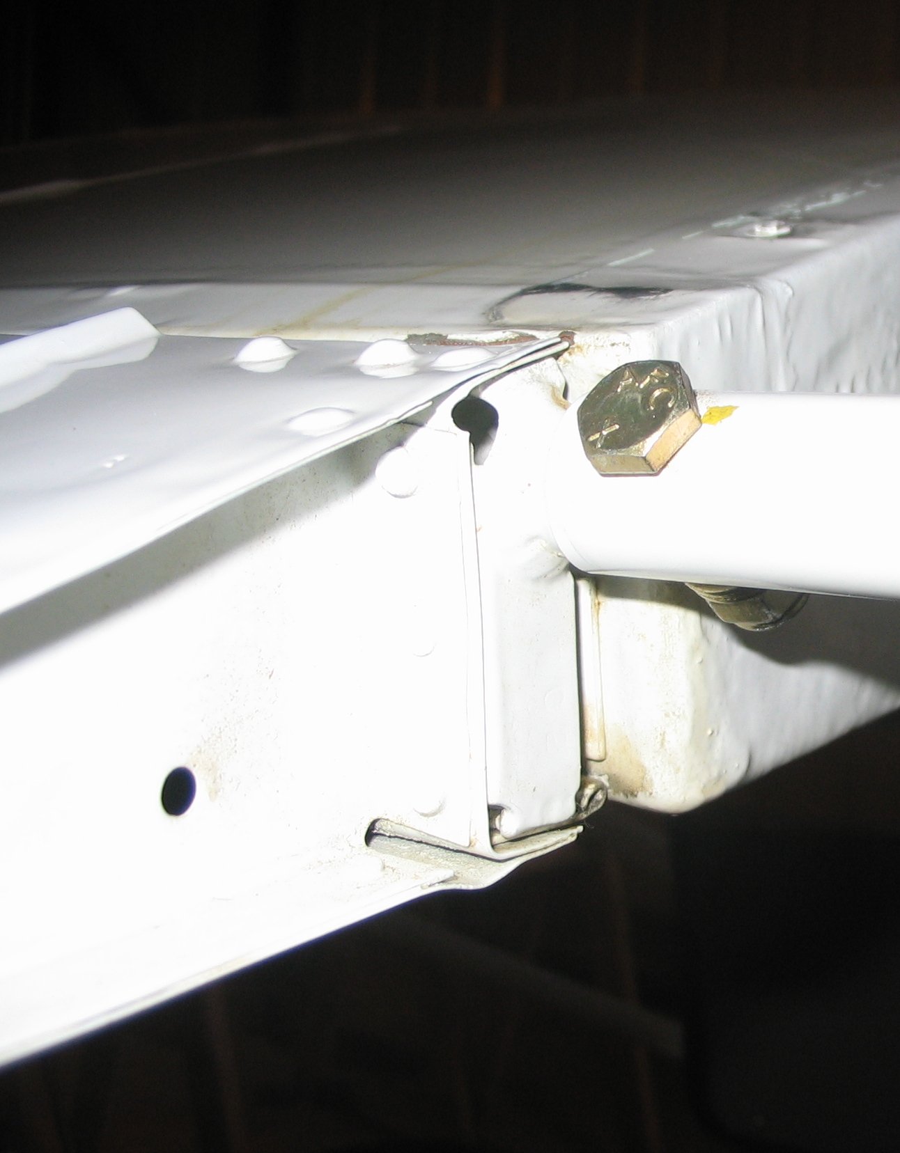

A little better look from my bird...
Posts: 2811
Re: Crack in flap
You need a view like the one above. Look closely at the relief hole in the spar where it's bent from vertical to horizontal. Also, you can pull the flap down by hand and get a look at the bracket and spar from the forward facing surface.
I haven't looked at one recently, but I think I'd try to put the doubler on the underside of the skin, if only for looks, but I'm thinking you'll need a rivet or two on the "inside" (outboard of the rib) to do it right.

Posts: 2811
Re: Crack in flap
8281 wrote: ↑Tue Jul 30, 2024 4:37 pm allow for the difference in angles between the flap torque tube and the wing Dihedral
Yes! It's sort of a crude universal joint.
Posts: 2811
Re: Crack in flap
6643 wrote: ↑Tue Jul 30, 2024 3:12 pmLook closely at the relief hole in the spar where it's bent from vertical to horizontal.
Maybe I didn't state that very well. Look at the area in the circle:
flap spar.jpg (246.22 KiB) Viewed 7804 times
