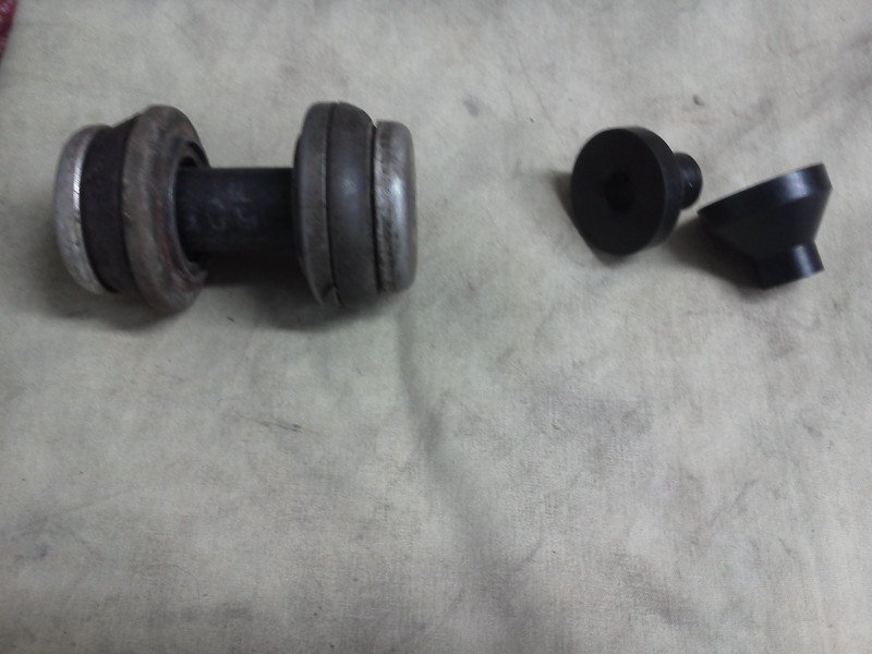

I had a similar thought about the mount. Not sure how to inspect that. I will ask the IA helping me. Unclear if they just reused bolts from old mount or if bolt wear was from this mount. The mount has a big metal flange where this bolt wear occurred; i dont see that flange wearing down or being a problem but I can check the holes for roundness I guess. The mount bushings I just removed were in adequate shape, just cracked on the outermost part of each one where it gets compressed by the washers. So whatever damage hit these bolts is not from the most recent bushings wearing thin.
When I think about it, aren't these bolts all going to wear where they exit the mount on the engine side? The motor is cantilevered off the mount bolt and the bolt is not constrained in bending, due to the entire engine-side mount assembly being rubber. So there is both a shear load and a bending load on all the bolts, and no bushing or liner between the bolt and the mount tube exit. This explains why the grooves are only 180 degree.

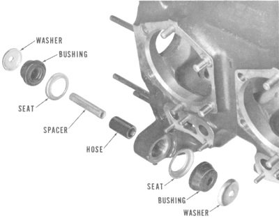

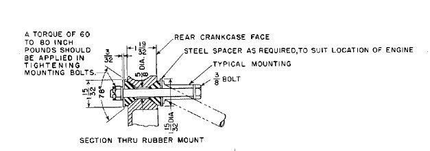

atypicalguy wrote: ↑Sun Jul 20, 2025 9:24 am Ok so what does the normal early mount look like with the conical rubber bushings? They must have a conical surface to land on and a washer on the outsides to smash both rubber bits into the conical mating surfaces. So what was the stock Cessna setup for the conical mating surfaces for those rubber pieces?
No, the mounting surface is the same. The only difference is the 140a mount is about an inch shorter from the firewall to the mounting surface.
The "conical" comes from the shape of the surfaces in the engine mounting ears.
Conical mount.jpg (24.08 KiB) Viewed 28344 times
Lord mount.jpg (17.99 KiB) Viewed 28344 times

Thanks for clarifying. My motor has an o-200 case, so I dont have the conical mating surfaces for the bushings. I have turned aluminum adapters with a PMA number on them from some Luscombe outfit which convert the o-200 holes (maybe designed for the later style Lord mounts) back to conical seats. I suppose this was done to preserve the original old style engine mount frame.
Anyway I ordered the old style bolts and they fit perfectly with new rubber cones. I came here to ask the proper torque spec but I see you already posted that diagram, so thanks again.
