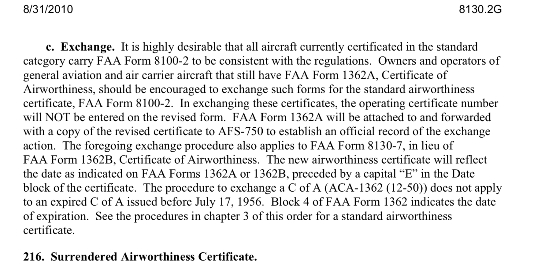

I'm doing an Annual inspection on a 170B and it has an old CAA airworthiness in it and reminded me of this post. Doing some digging, I found FAA Order 8130.2G, 215 par C talking about replacement certificates using words like "Highly desirable" and "should be encouraged to be exchanged" but doesn't sound mandatory. As long as it is dated after July 17, 1956 they no longer expire. I can imagine if the plane was flown to another country Customs may have an issue with it not being the modern 8100-2 form.
Jeff
