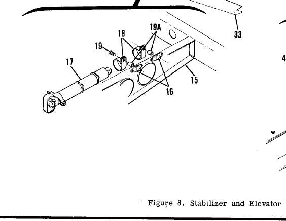

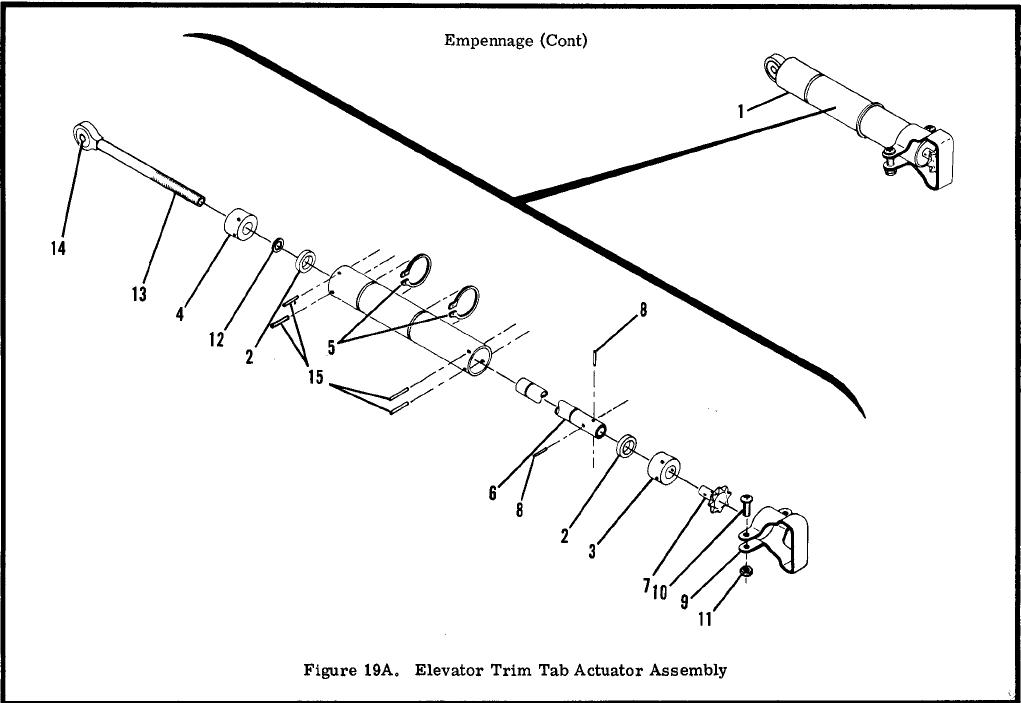

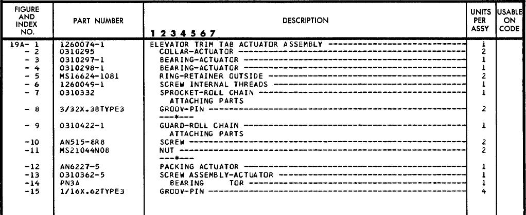

Tye Hammerle » Thu Jul 19, 2007 10:36 am
Diagram from the Parts Manuals might help.
- Fig 8 from the 63-69 150 IPC. Serials 17001 & up. No detail of
- fig8_pre63_195.jpg (27.25 KiB) Viewed 80864 times
- Fig 19a parts list from 70-77 150 IPC.
- fig_19aplist_776.jpg (92.28 KiB) Viewed 80864 times
- Fig 19a from the 70-77 150 IPC. Exploded view of actuator.
- fig_19a_147.jpg (72.03 KiB) Viewed 80864 times

Re: Trim Tab Actuator
Bob Tofsrud » Thu Jul 19, 2007 10:48 am
Tye
If that breakdown is typical of the actuator on our planes your right about turning it 90 degrees to help eliminate some of the movement. This shows the chain guard as a clamp on type.
Bob

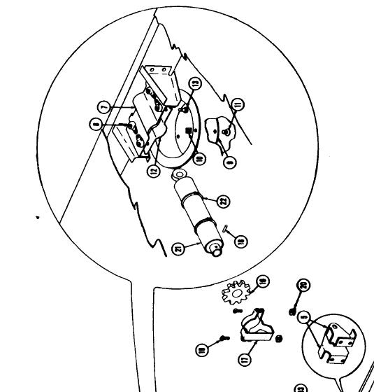

Tye Hammerle » Thu Jul 19, 2007 7:29 pm
This picture is from fig 12 in the 120-140 IPC. It looks to me like the same style as the 150 manuals. The one I have seems quite different. This one has two snap-rings on the body whereas mine doesn't and the chain guard is a clamp type verses screwing to the end like mine.
