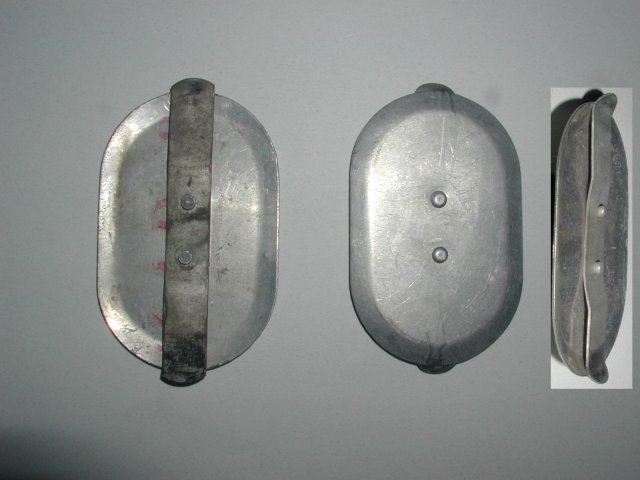

I know this is probably like looking for a unicorn in a pot of gold, but I'd really like to buy both the oil tank baffle and the oval plugs that are part of the winterization kit. Alternatively, I'd like to borrow them to make copies. As winter has rolled in, my new-to-me C140 is struggling to get oil temp above 125, even on a 40 degree day.

Oil tank baffle? If you mean the metal plate in front of the tank, that's a cooling part and is required, year 'round. If you mean the "blanket," it's available from Wag Aero. Click here.
You can make the oval covers from sheet aluminum and the spring from a fabric inspection cover. Make the ovals 1/4" larger all around than the holes and bend the edges down about 10 degrees. (Duct tape works pretty well, too...)
To get a real increase in temperature you need the covers for the inner halves of the big openings in front of the cylinders.

John, thanks for the info! I am looking for the cooling baffle too. My summer oil temps are 225+, but on my first “winter” flight with air temps around 32 at altitude, my oil temp never got above 125. Gonna close off the blast tube that points at the temp sensor, but I know that won’t get me more than an indication change. Temp sensor is new, so I wouldn’t expect it to be bad. Anything’s possible though...
Since I don’t have CHT gauges, and it almost never gets below 20 here in the winter, I’m not that excited about covering the big openings at the cylinders.

hotrodmac wrote: ↑Wed Nov 13, 2019 6:38 amGonna close off the blast tube that points at the temp sensor, but I know that won’t get me more than an indication change.
If by that you mean it won't really change the temperature of the oil, that's not true. The plate over the blast tube is good for about 10 degrees, IIRC, in actual oil temperature. All the oil flows through the screen housing, and the probe is measuring the temperature of (all) that oil. The blanket for the oil tank is good for about another 10 degrees, the oval plates about 20.
I'm having drawings for the cowl grill plates posted int he member's section of the web site. I'll post a link when it is available.
You can use duct tape to try out each of the covers. If you cover the grills, cover only the inboard sections, and no more than half of the total area. Do not block airflow to the cylinder heads.

8233 wrote: ↑Sat Nov 16, 2019 12:23 amI know don't have that on my 120 with a C-90 and I also have the more oblong style oil tank.
OK, technically, that oil tank isn't "allowed" on the C90 that's approved for the 120/140. That said, since it's used on the O200, Randy probably has an answer. (I don't know of an equivalent part for that tank, so I suspect the answer is to omit it.)
do you know anyone who can fabricate such a piece?
I was recently in communication with a company that makes replacement baffles, and they said the compound curve in the C85 part is not compatible with their manufacturing processes. That said, with a wide tank like yours, you might get almost the same benefit from a piece with a simple curve, rolled from top to bottom to match the tank.
I would like to get that added on mine to help with cooling in the summer.
Do you have the blast tube on the oil screen housing, and the extended lip on the bottom of the cowl? Both of them make a significant difference.
