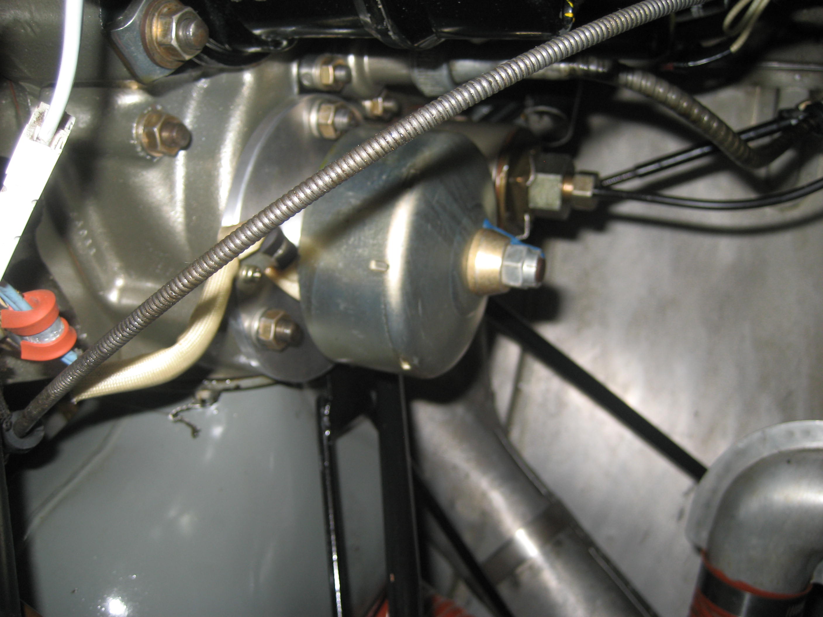

Yet another option that may be worth considering(?), the B & C "Alternator". This (photo) is the "12 Amp" that was installed on our 140 a number of years ago via field approval. It has performed flawlessly with dependable B & C quality built right in...and, continued airworthiness directions indicates it'll go to normal engine overhaul, so no "maintenance" except for the normal drive coupling check @ 500 hours. While not a true alternator (...a "dynamo"?), it provides clean power at lower RPMs and easily supports all avionics, now including ADS-B in/out + landing light (with LED bulb). There's also now available a 30 Amp model...believe it's STC'd for some installations. Both weigh in at slightly over 4 lbs.(!), so significant weight savings. Fellow member Tom Reddeck has flown behind an identical 12 Amp, also "field approved", on his 140 for years and echoes similar positives. FWIW. Mac

The cost of the replacement generator, regulator, and circuit protection device is going to be significant compared to the cost of an alternator installation. You may also have to replace the ammeter, depending on its range. And, again, this will do nothing to improve your electrical system at engine speeds below about 1800 RPM, when the generator will go off line. So, if your problem is the landing light in the pattern, a bigger generator will not help. A used alternator from a Cessna 150 along with the correct regulator, and Fred Lagno's STC, would probably be the most cost effective route to take. The plane power setup saves you some weight, to boot. The B&C alternator scares me as the outer housing spins, plus I think it's only 12 amps, although it will produce current at idle, unlike the generator. (Mac: Isn't that thing supposed to be painted traffic-cone-orange?)

Post by 8474 »
