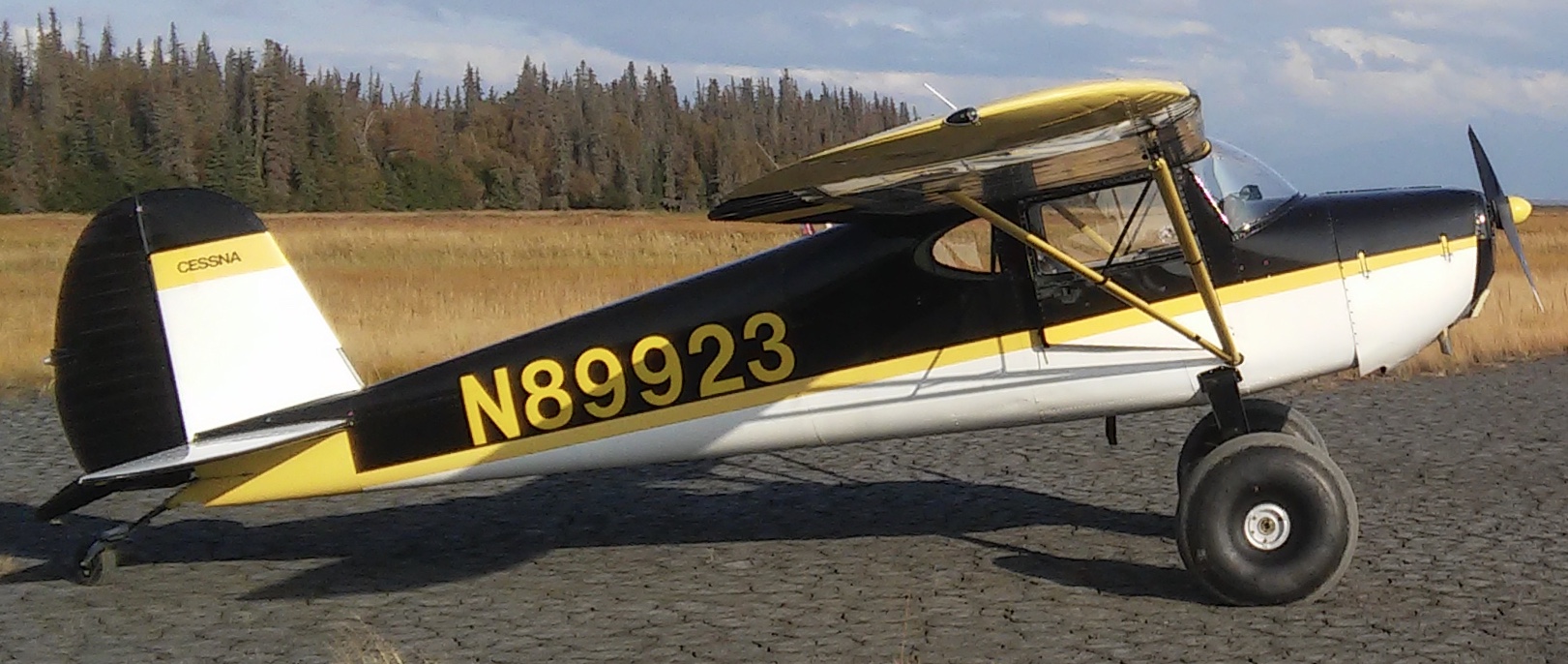

So every bush strip is short with giant obstacles on the end.....Guess all those years flying off beaches, gravel bars, mud flats and ridge tops in Southwest Alaska don’t count. One thing is for certain you gotta pick your strip really carefully cause that tail section is pretty weak at the bracket and the spring attach points. I beat the hell out of our 140 when I was in my teens and now that I have completely restored it (it wasn’t cause it was wrecked either) I baby it and it stays off any rough stuff. At gross with an O-200 and 69/50 prop I can do a stop and go within 1000-1200 feet. That’s pretty good for having stubby metal wings and being a heavy 140 overall. I might haul it in the air at 400-500 feet but I won’t be clearing any 50’ obstacle soon after. That’s with 8.50x6.00 tires on pavement, if those heavy 29” bushwheels at 5 psi are installed It easily ads about 70-100ft. add some soft sand, mud, knee high grass or standing water and ours needs a good 1500+ feet to get airborne.
I think any plane is only as good as it’s operators experience level. There is a fair amount of 120/140 planes up here that are used off airport for people that can’t afford a Husky or Cub. It still allows those folks access to some good fishing and hunting areas safely at a reasonable cost. Yes, it wasn’t specifically designed as a “Bush” plane. As long as your careful it can take you to those “Bush” places. That said It doesn’t even come close to the safety margin our Cub provides as far as short field/obstacle issues are concerned.
