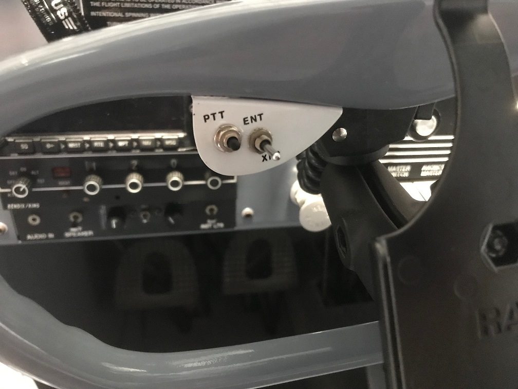

Who has mounted a PTT switch on their yoke? Mine currently has a velcro switch on the yoke, but that won't work once I relocate the plugs to behind the seat. Trying to get some ideas on how to do it. I've seen one with a decent design, but haven't seen any others.
The one I've seen:

Have you seen the product from one of our member. Pretty neat.
https://www.cessna120-140.org/Classified/talkclip.htm
Martin Tanguay

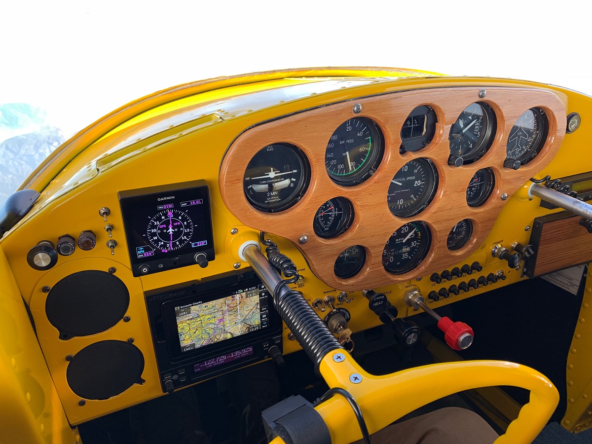

Not as pretty, but I ended up just coiling the switch around the yoke then tucking it into the panel. Works great and is clean. I cut the end of the switch and wired it directly to the radio.

Thanks, Tamer for the pic. I did some research on drilling a small hole in the shaft to run the wire inside...general conclusion is it probably isn't a good idea at best, and may require more than a log entry by the IA. I probably will do just what you did with the velcro ptt...wire it to the radio. I had it zip tied to the shaft and ran under the bottom of the panel to the portable intercom in my first 140.
