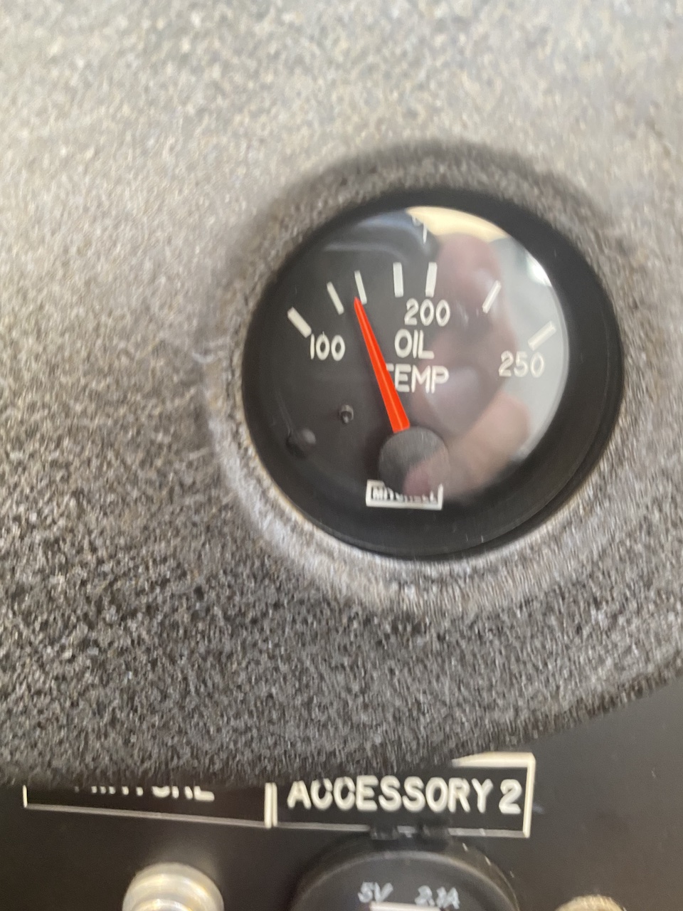

I'm in the Charlotte, NC area and I did some oil temp testing over last weekend. I have a C-85 with a little over 100 hrs since major and I struggle to get warm enough oil in the the winter. Last Sunday with the air temp in the high 40s, low 50s F, with the small cowl holes and blast tube taped over, and 2 inches of tape over the inboard end of both cylinder grills I almost got 150F oil temp on the gauge. Air temp at 3000 ft was around freezing. After I landed I pulled the tape off the cylinder grills, but left the smaller holes covered, and then repeated the flight. My oil temp never got above 125. I'm having a set of winterization covers built. I can't say I'm excited about flying around with the grills partially blocked since I don't have a CHT gauge, but It's the only thing I can think of to get reasonable winter Oil Temp. I don't know how the owners that get a real winter do it. Sorry for the fuzzy pic, it was a little bumpy out.

It's OK to cover the inboard side of the grills, in front of the cylinder barrels; just don't cover the portion where the cylinder heads are.
I assume when you refer to the small holes you mean the two ovals under the prop opening.
Wag Aero sells the blanket for the oil tank. It's good for about 10 more degrees.
Have you calibrated the oil temperature gauge?

John, I do mean the small ovals under the prop opening. The gauge was calibrated a little over 2 years ago when it was installed by the previous owner, I haven't checked it myself. Probably wouldn't hurt to do it though.
