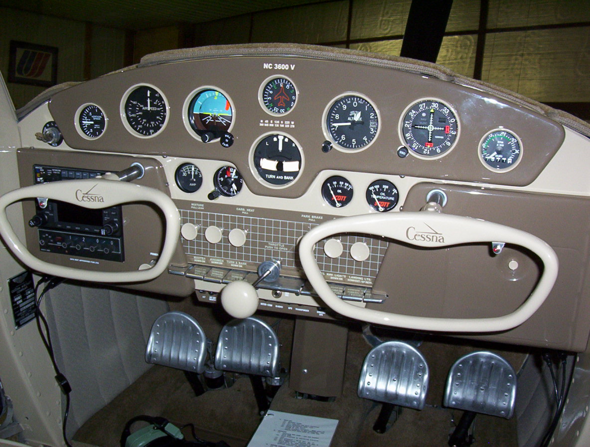

Thanks for the complement Mac . I have restored some 20 of the later style yokes to date. Custom colors or as close to the stock look also. The control tube I have "Hard chromed" and I have made the tooling to press the original tubular rivets to hold the yokes to the tube. I have sets in stock to restore or have done a exchange with cores. I will also take any calls or e-mails to assist with anyone willing to restore theirs themselves .
- 100_1424.JPG (243.4 KiB) Viewed 3534 times
