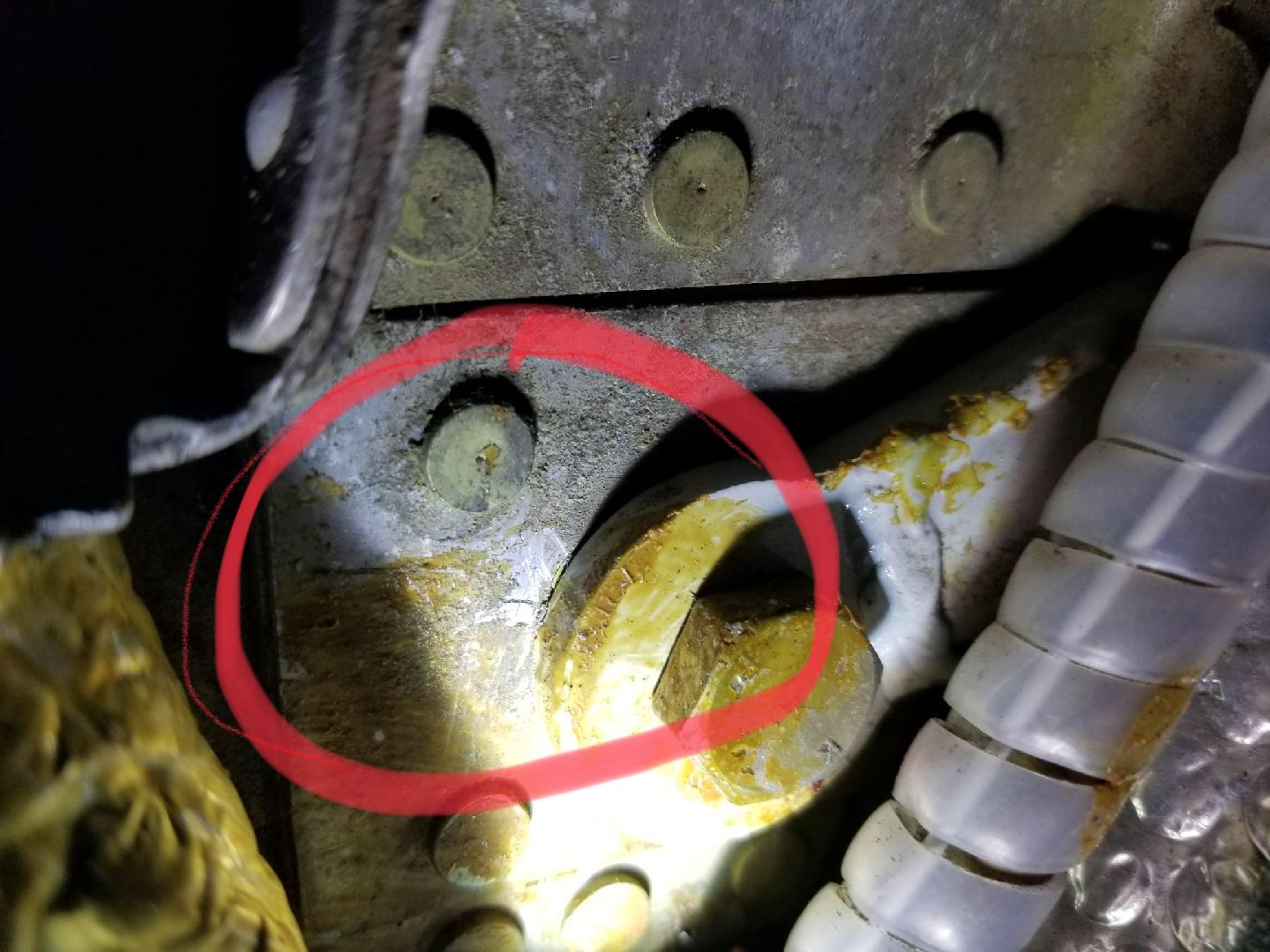

Well, unfortunately I had to walk away from the deal for 3 reasons. The seller was not interested in adjusting his price based on what my IA and myself found. Even with a price adjustment, I might have still walked. Here were the 3 show stoppers, tell me if you agree or disagree with my decision:
1. There was corrosion in the wings and tail. My IA said it would not prevent him from signing off on it at an annual but I would have to stay on top of it by fogging it ever year and so on. In the wings, we found it on the stringers and the spar.
2. His logbook gap was much bigger than he first thought and upon closer inspection, he basically had zero logs before a 1994 restoration. Airframe log was labeled at Book #4 and first 3 were missing. Same story on the engine where it was #2 and #1 was missing. The restoration of both airframe and engine were in the records for 1994 to current date. I was told that missing 50 years of logs can cut the value in half. I don't think everyone always agrees on that point but it wasn't a comforting development to say the least.
3. Last one was there was a crack in the structure at the left wing strut attachment point where it runs into the fuselage. It was an airworthiness issue per my IA but it was repairable for likely $2500 or more.
The plane on the whole actually looked really nice, paint was good, needed some polishing, but it was evident it had spent the in the southeast including Georgia and I suspect Florida. The interior and panel were also is nice ship. Overall curb appeal was very nice. I had offered and we had an agreed upon price I thought was fair but t was based on a successful pre-buy. When he refused to even talk about a lower price, it was a no brainer to walk away. Some of you would have likely walked anyway between the missing logs and corrosion.
Did I make the right call in your opinions?

Re: Metalized Wings and Pre Buy
The third photo is of greatest concern. Cracks in the door post/gear box are often a can of worms.
