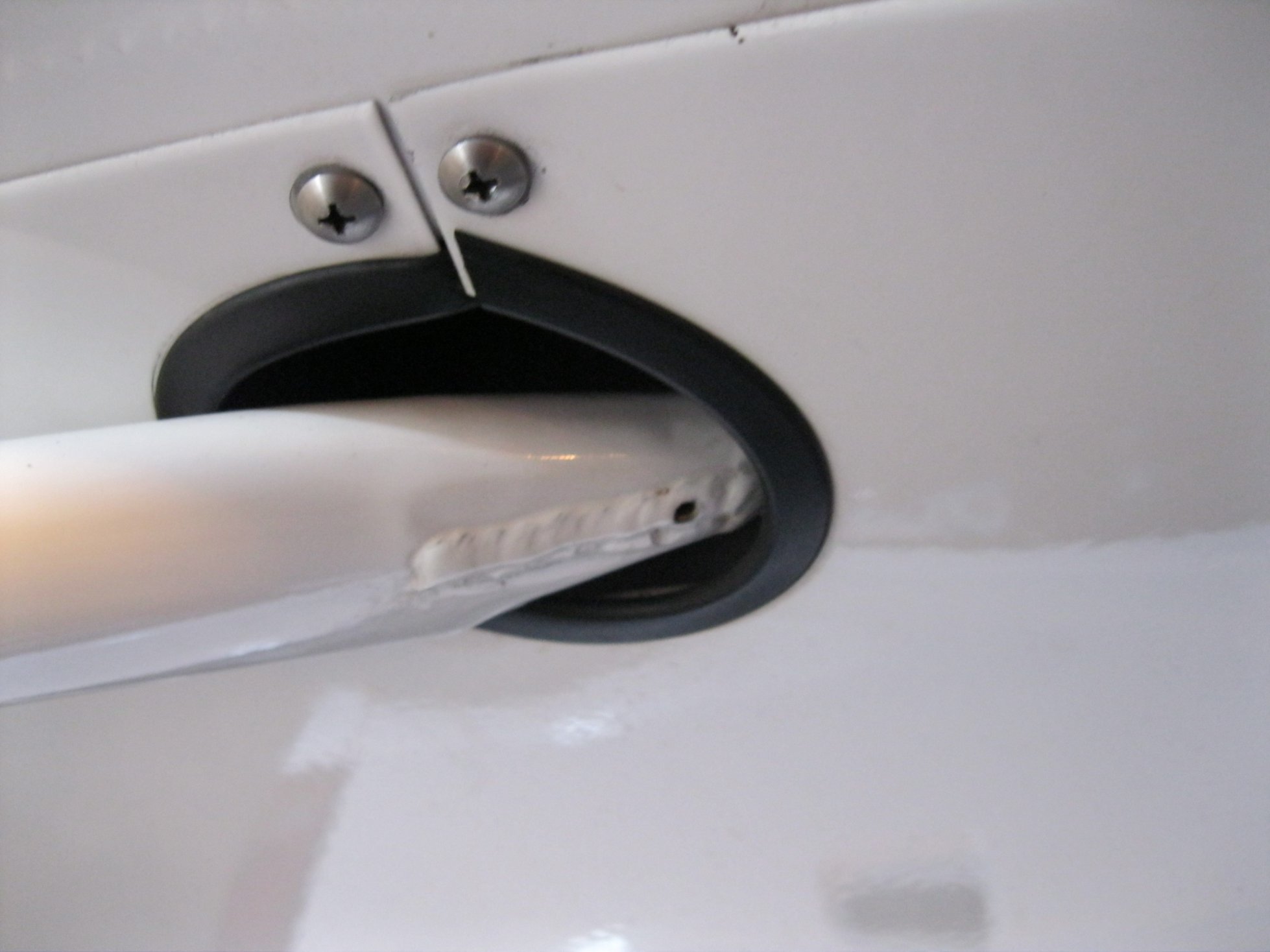

Witness holes near the wing attach points will be on the bottom of the struts.

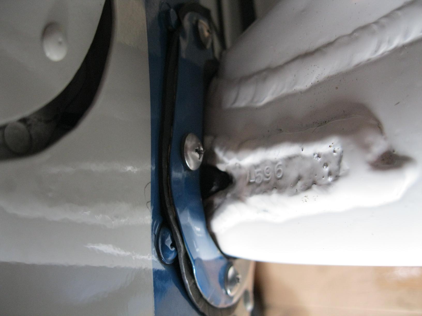

My early 140 struts have a number stamped on the weldments on the upper portion near where the struts attach to the fuselage.

Each strut should have a serial number stamped on the fitting where they attach to the gear box. The stamping should face up. If you try to install the left strut on the right side (or vice-versa) the rear strut will be about 1 foot too low. (Oops, Dave beat me to it...)

Thanks guys for the great information. I found the part numbers on the struts under years of coats of paint. but they don't have the same part numbers as the IPC one is R5696 or might be R5096 and the other is L2452. Also the 2 extra sturts I have one is bent up a little, is it still worth anything i've heard people can use parts of it to fix other ones. and the other strut has a different end on it like a cap with a hole and a tie down and its in great shape. why is it different?

They aren't part numbers. They're serial numbers. And, I bet you can guess what the "R" and "L" stand for...
