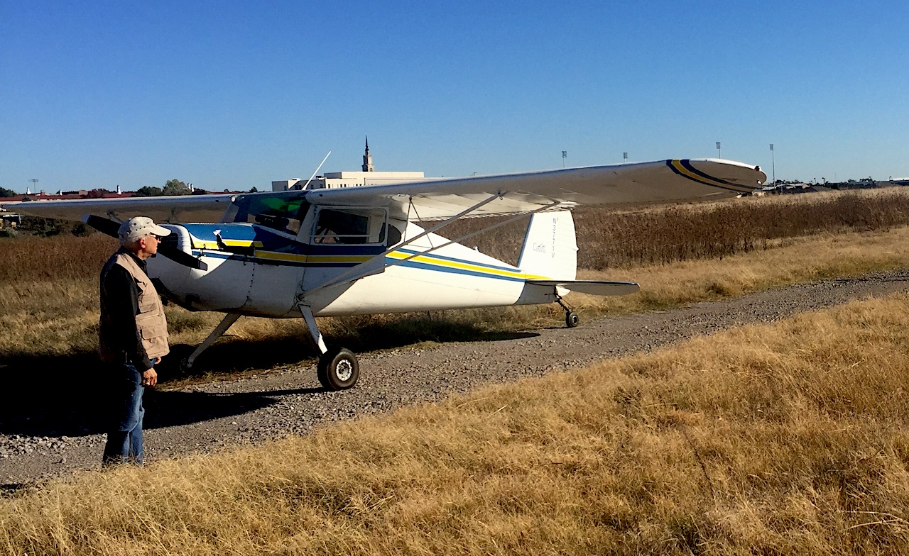

I have had the 1948 aircraft since 2017. At the time I was training to get my pilot's license with the intention of finishing out in the 140. Since it had no dual brakes, I had a terrible time finding an instructor toward that purpose and was advised to finish out in a more common type. It was good advice and that being accomplished, I then looked forward to flying the little Cessna as my primary aircraft and to obtain lots of tail wheel experience to further my goal of flying WWI biplanes.
Things were progressing nicely until November 2019 when on my 4th take off and landing from a full stop, I had a complete cowl latch failure, (not a pre-flight issue but an actual structural failure of the latch). The left cowl metal began to lacerate down the middle, perpendicular to the center piano wire hinge, and threaten the canopy and prop. I was able to make an emergency landing on a service road with no major harm to us but did have the cowl damage and clipped the left wingtip on a post.
Since there was no major damage to anything or to us, the 'occurrence' caused me no problems with any authorities but did open my eyes to just how little insurance companies regard these old planes. After nearly three months of back and forth, a 'totaling' of the aircraft (which still defies imagination as it was a left wingtip, 12" of leading edge, two nose ribs, and the left cowl as the only damage), and a $5500 buy back, I have embarked since February on getting her back in the air.

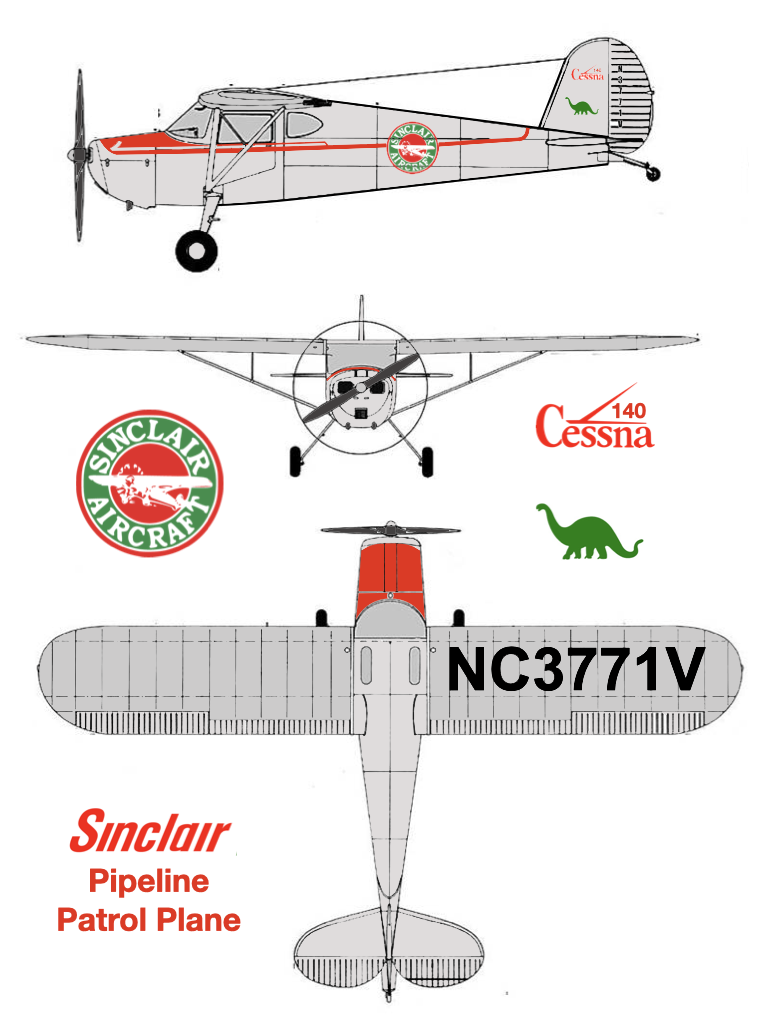

But what an opportunity. The aircraft always struck me as kind of ugly. You know, like a '57 Chevy painted with more 'modern' colors rather than letting it be what it is. The more I looked at it, the more I disliked the 1970s era paint scheme. So, knowing I was going to have to paint portions of it anyway and recover the left wing, and really not wanting to repaint an ugly scheme, I explored taking her back to the 1940s. I discovered she had a rich history with Sinclair Aviation. Without the emergency landing, I likely would have never taken on a restoration to bring her back to her service days with Sinclair Aviation in the late 1940s and early 1950s.

The exact appearance of the pre-paint era of Sinclair 140s is still unknown to me. The log books show the planes were not painted until 1954 (at least mine) when they metalized the wings. By the interior colors, I have determined mine had red exterior trim on the factory aluminum. I was able to get a fair idea of a representation of how it might look from talking to a former Sinclair pilot who flew during that time.

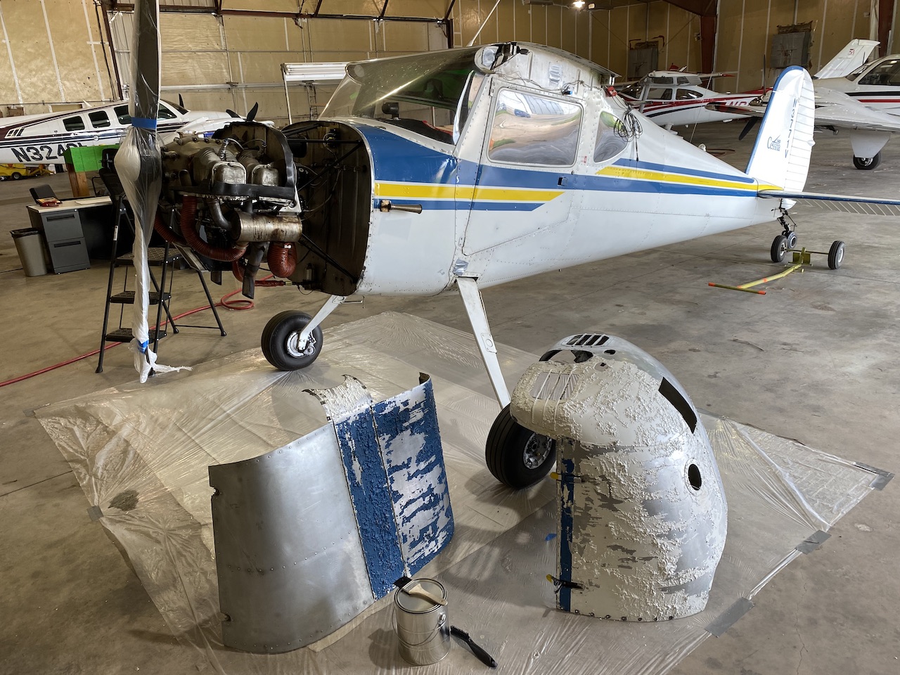

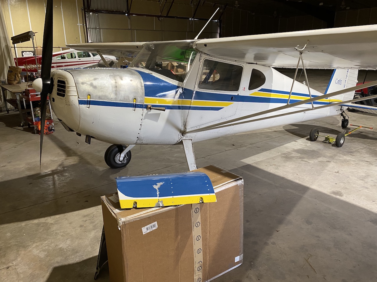

29 February 2020 - The first repair made was to the left cowl. I found an entire 1946 top cowl in good shape at a fair price. The 1946 door will fit, but you have to trim 1/2" from the leading edge. Everything else fits and matches great but the long hinge pins are slightly different. I can live with it.

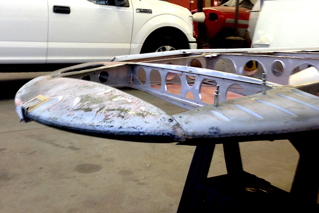

5 April 2020 - The next thing was to strip the wings, strip the fabric and fix the left wing tip and leading edge.

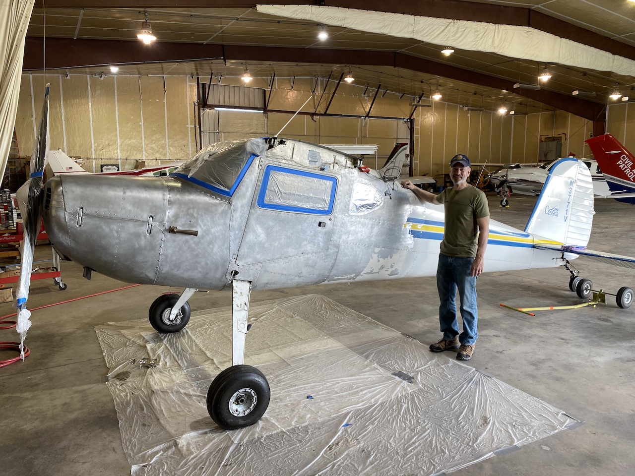

9 April 2020 - Then the tedious part. Stripping the paint. Every square inch. But underneath was an airframe in marvelous shape.

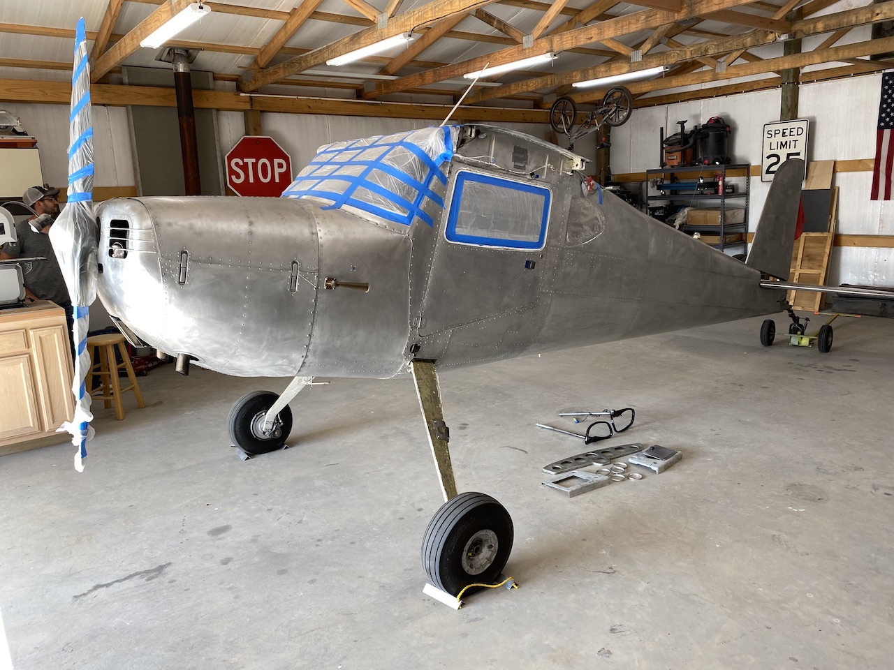

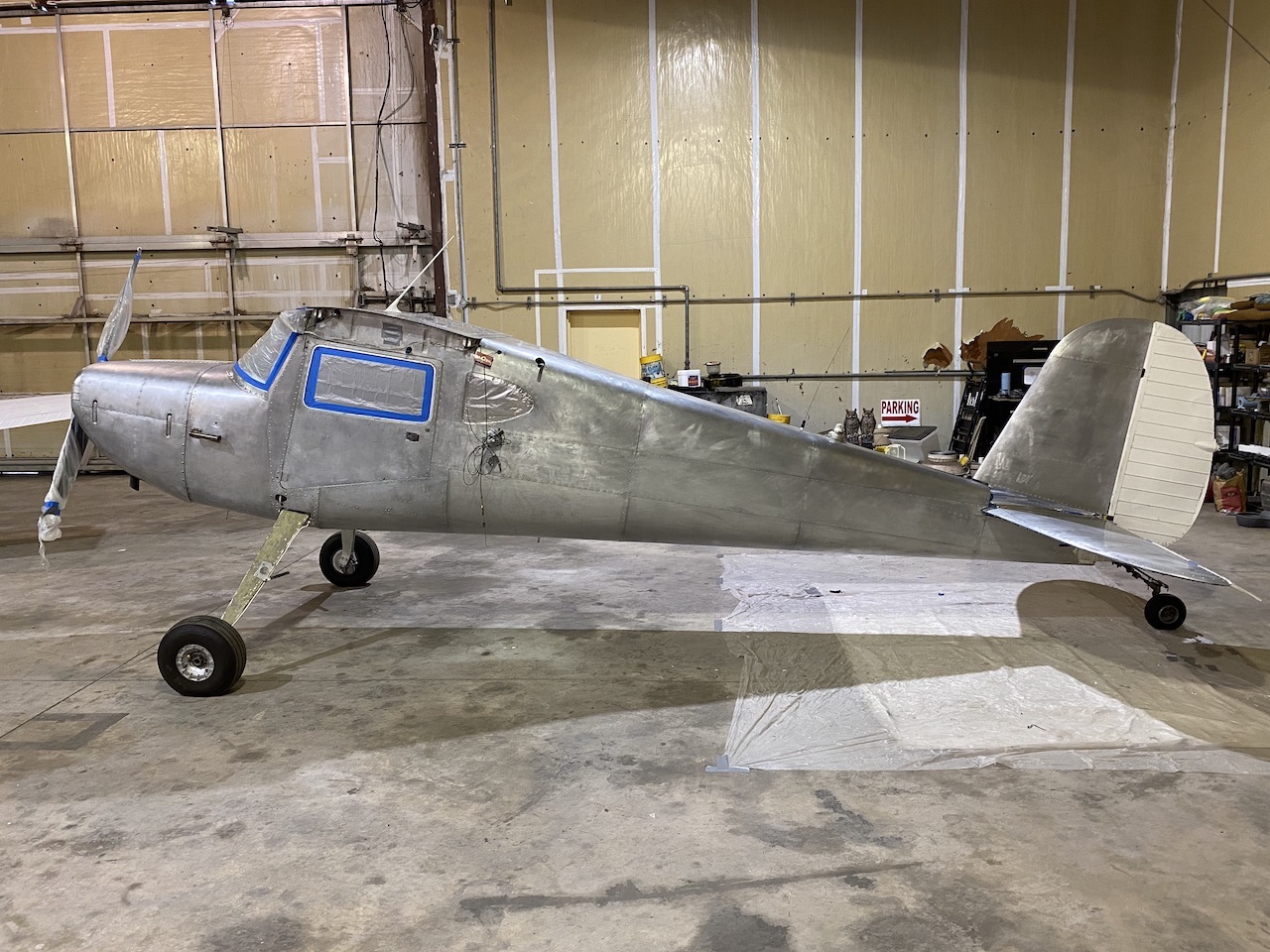

24 April 2020 - Working mostly on my day off on Fridays, I slowly begin to see progress.
29 May 2020 - All but the control surfaces are stripped now. Will remove those and save for when I strip the ailerons and flaps.

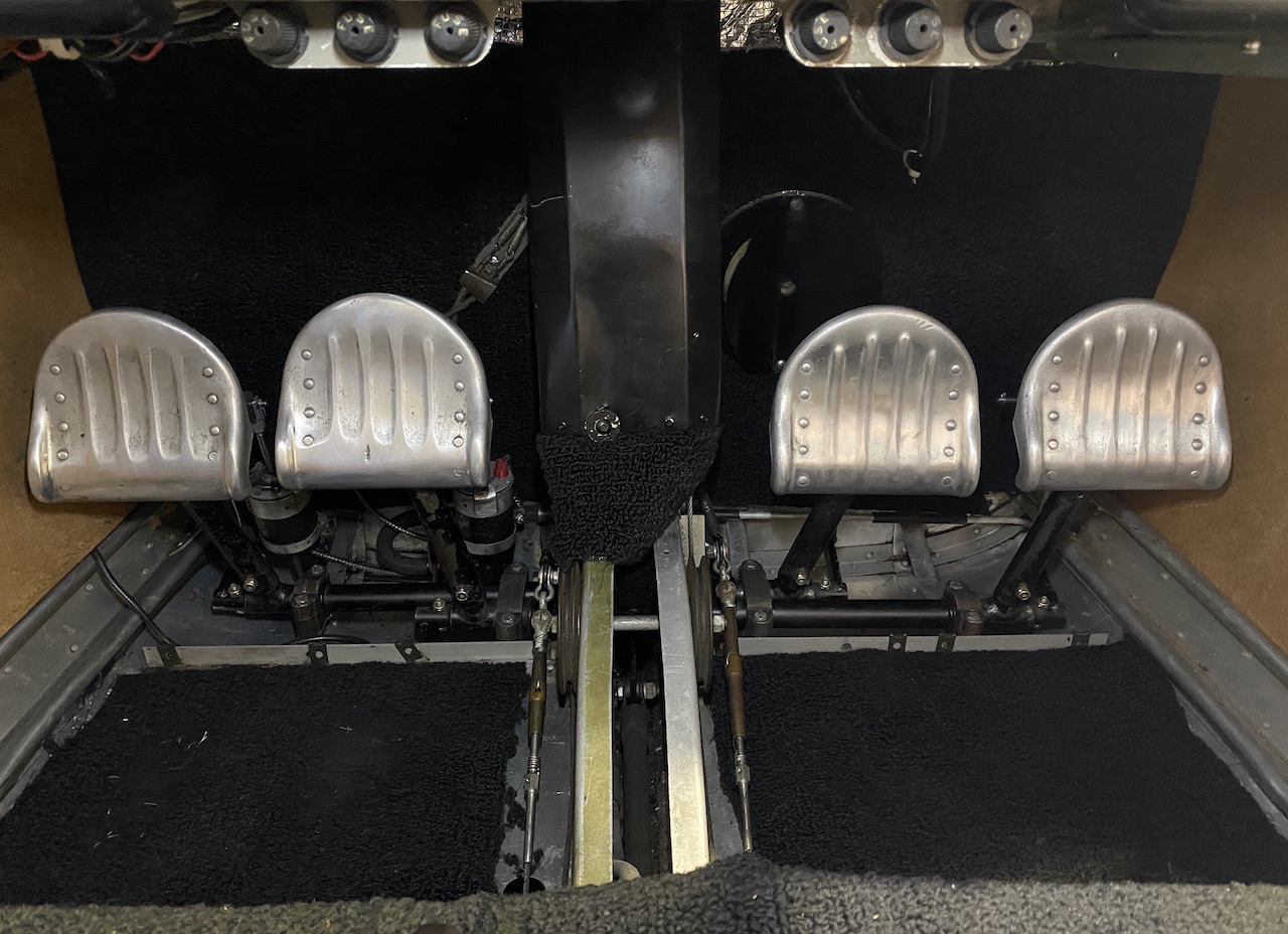

13 June 2020 - Brake time. Found a complete original dual brake assembly for only $130.00! With the help of the great folks here, who patiently answered my dumb questions, I was able to make the upgrade.
You can visit my dumb brake questions and more pics of that here:
viewtopic.php?f=7&t=1067

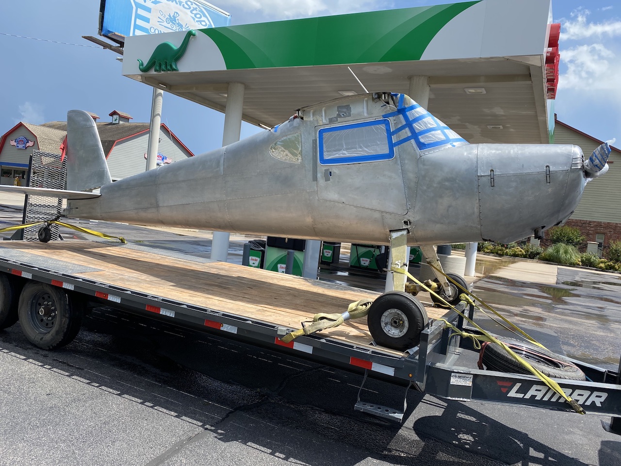

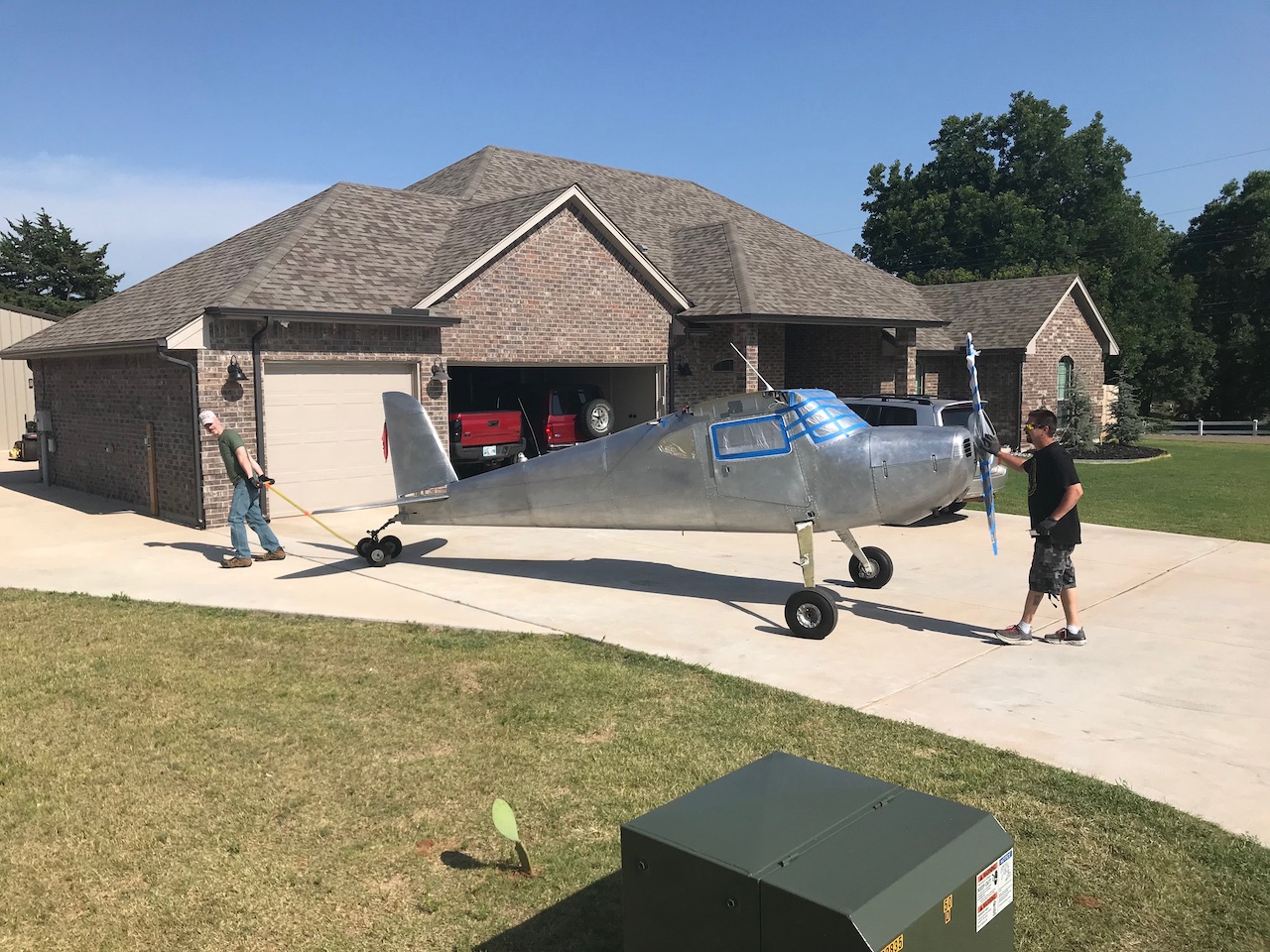

3 Jul 2020 - Time for another phase of work. We successfully moved the plane to be buffed out in natural aluminum and painted with the red trim. Got to love that our first short stop to check the load was at a Sinclair gas station! That was unplanned but very appropriate.
What's next - The wings! Time to study up on fabric covering. And I hope to do some cockpit work as well to bring it back to the original interior colors of gray and chocolate brown. At least that is what they look like to me. Lorraine Morris has been very helpful in helping me research that. While my goal is to restore the original look, I am not looking to win any awards. I want to get the plane flying again soon. Removing all the cables and instruments for me right now would be a major set back, as everything still works. So we will do some touch up inside to improve the appearance. After all, I am trying to restore it back to look like a working Sinclair oilfield pipeline patrol plane. To me it is OK if it is not showroom new.

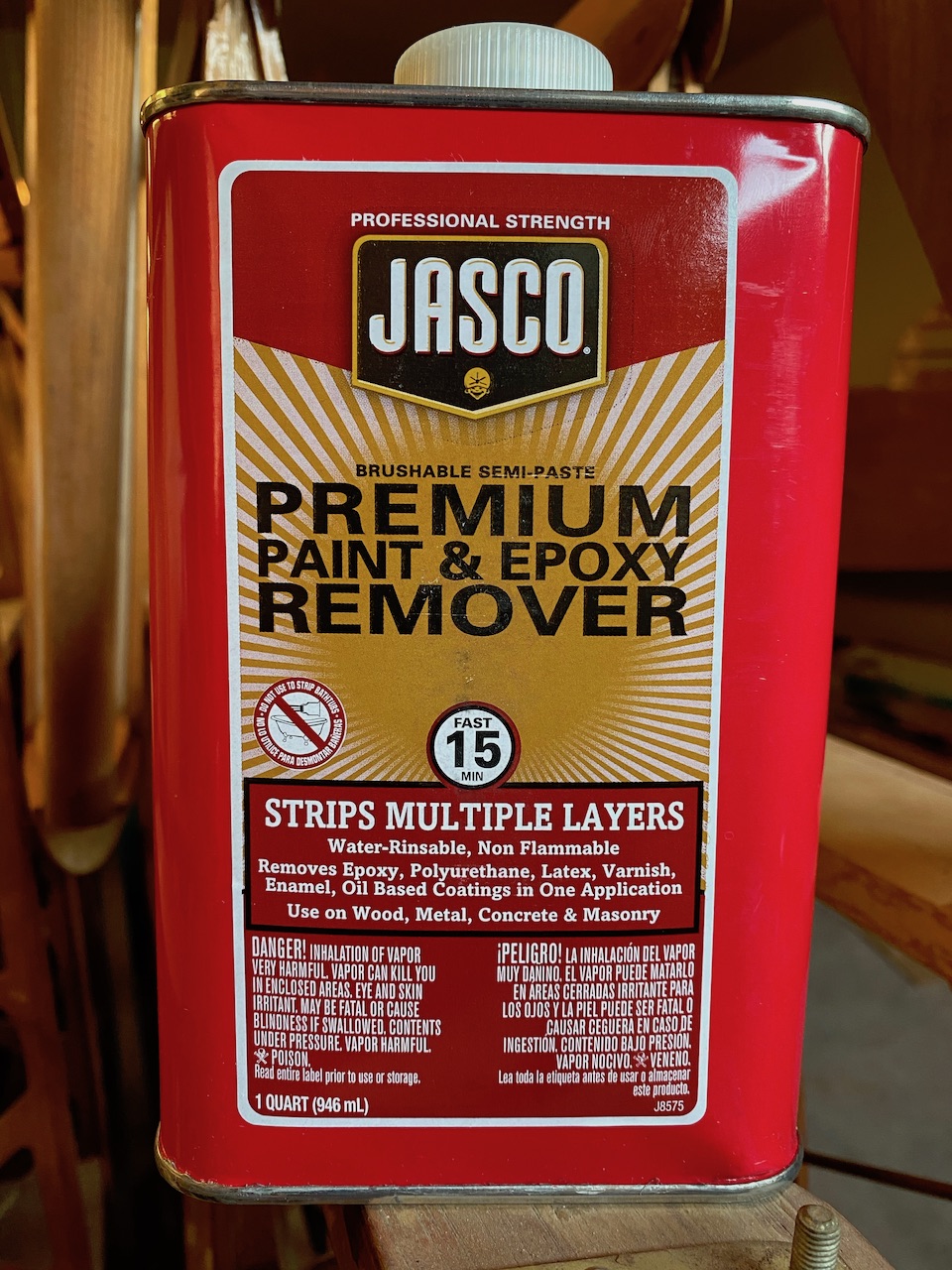

What stripper did you use to remove the paint? I can't find a stripper that works any more. None have the ingredient (Methylene Chloride) that kills brain cells but really makes strippers work any more! I have to strip and repaint all my "new" tail parts.
Thanks.

I used a Jasco product. Ordered it a couple of weeks after the emergency landing so I guess I beat the EPA mandate. It took about 6 quarts to strip the entire fuselage. And LOTS of scraping. Steve8424 wrote: ↑Mon Jul 06, 2020 4:32 am Hi Steve.
