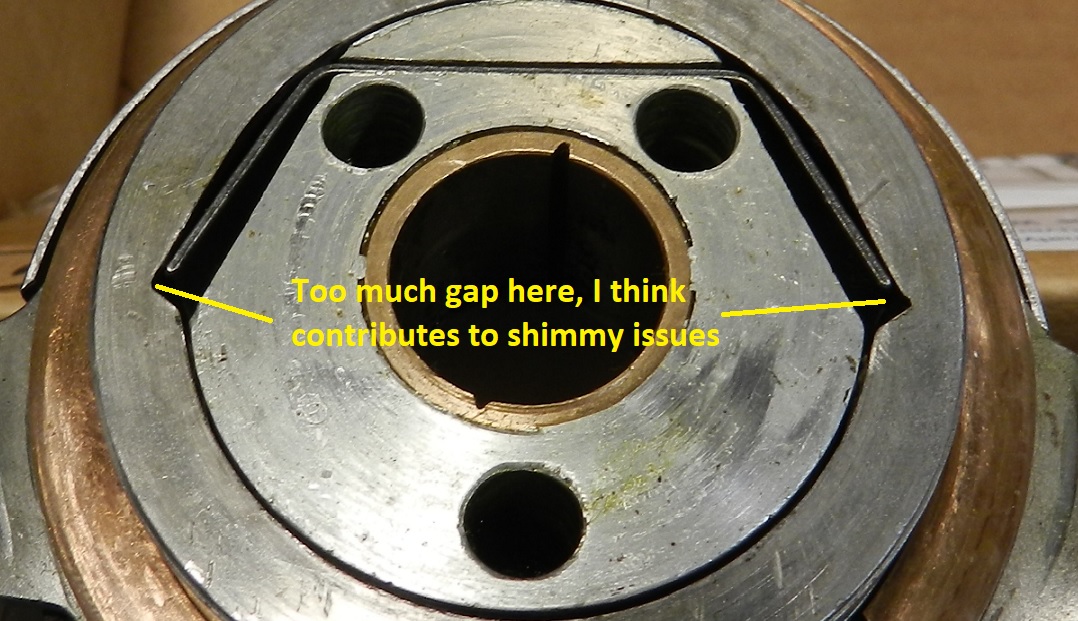

If you have an old tired 3200 unit check here, otherwise the previous post from Alaska is gold-
- scottpic.JPG (45.93 KiB) Viewed 12613 times
- flat spring gap 3200.jpg (244.33 KiB) Viewed 12613 times

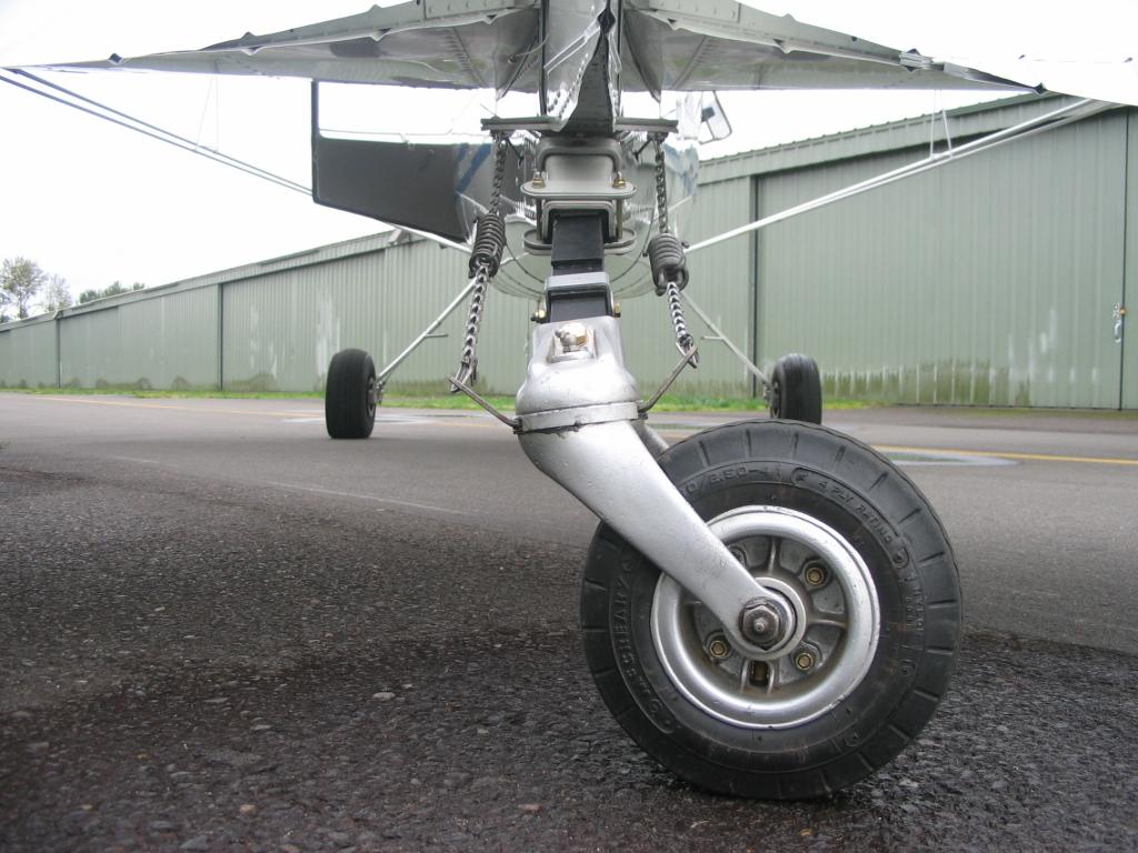

I had to tighten up the abrasion strips and rubber pieces that secure things a little tighter. There was simply too much slop and play. This is the 'before' pic when I first got my bird (and yes I got rid of the Maule springs before anyone does a 'gotcha'). Only a possible contribution to your wear issue.
The nuts and bolts and rubber pieces (you can fabricate) are pretty much nickel and dime stuff. The main bolt forward that holds the whole shebang together should be replaced if you don't know the history. Some folks advocate replacing the tailwheel spring set after 'x' years. Do check which spring set you need- double or single bend per serial number.
