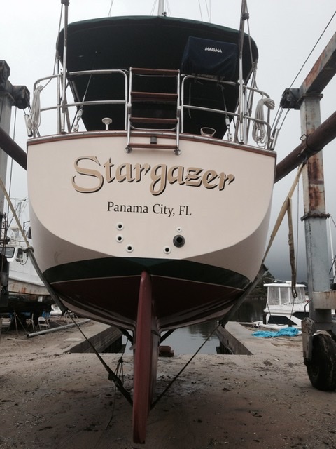

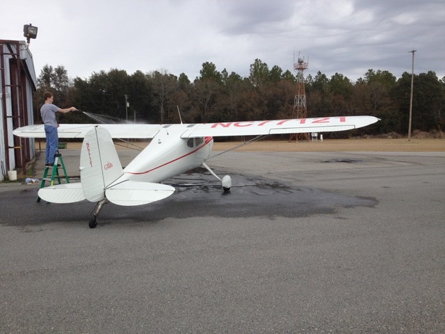

Smaller, especially on flat surfaces are easier. I don’t know how well you can see it, but my registration numbers on the wing are red Vinyl, and while I believe it may have microscopic holes it’s smooth, larger sections wouldn’t be.
Suggest you contact a vinyl company, they are sure to have something around they have wrapped, often an automobile or truck for you to inspect.
Smaller sections will last a very long time.
Stern, of our boat is vinyl, as again painting is much more difficult.
Both will last years, boat is never hangered either.
