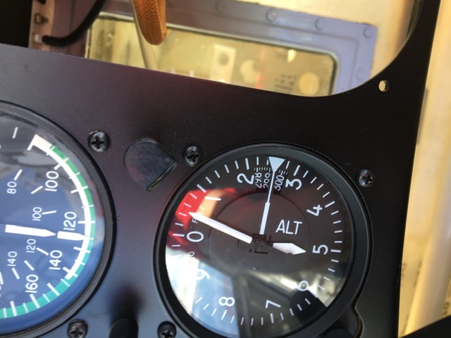

For instance the Certified ceiling for all S2R’s is 12,000 ft, but I did some engine testing at 25,000 ft. So the Certified 12,000 ft is not a limit, just simply what it was Certified to.
