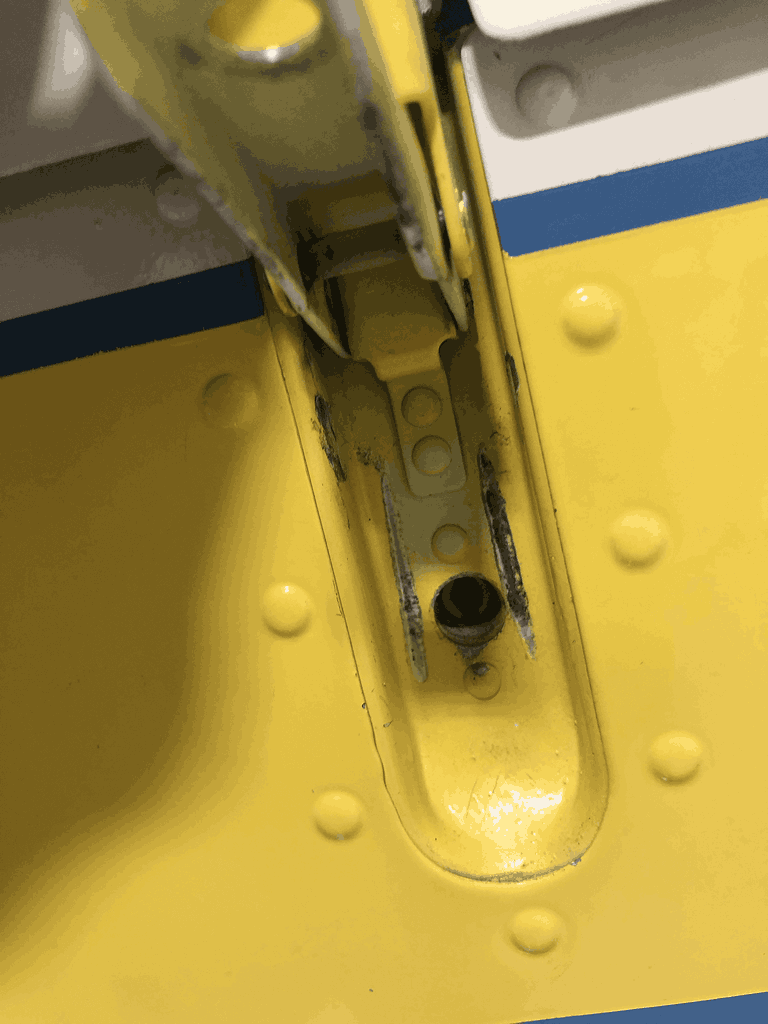

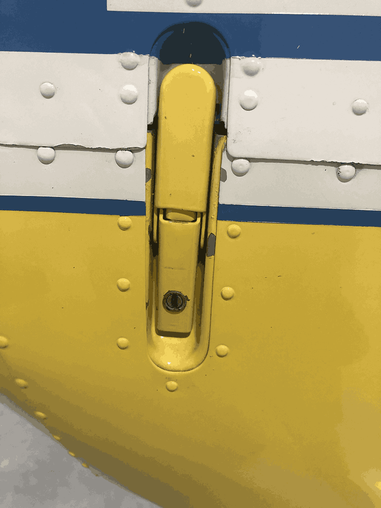

Our 140A has cowling latches with a quarter turn fastener to hold them closed. Two of the fasteners have lost the part that holds the fastener in the latch when open. I'm looking for parts or whole fasteners. Fairly easy to find the fasteners when they fall on the hangar floor - probably won't be so lucky on grass!

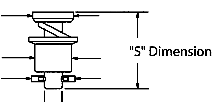

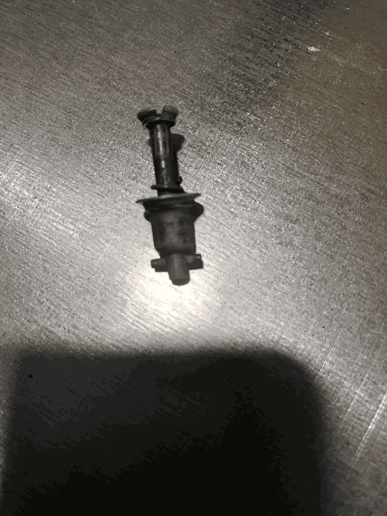

Is your only problem that the studs don't stay in place when you open the cowl? There is a part called a grommet with a retaining ring that is supposed to keep them from falling out. If you can measure the diameter of the body of the stud where it passes through the latch) I can give you a part number for the grommet. If you need the whole fastener I need diameter and thickness of the material, not including the receptacle. Alternatively, to replace the one you have, measure the overall length of the stud ("S" in the picture) from the face with the screwdriver slot to the end past the cross piece.
Looks like the spring may be broken on your stud. If so, the grommet may still be in the cowl latch. Without the spring, the stud is free to fall out.

Thanks for the information. I used some up-drilled washers to press on the shell and some RTV to hold them in. We'll see how long it lasts. I'll keep the info for measuring them for the future.
