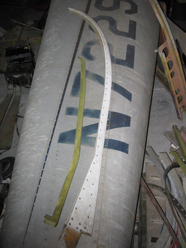

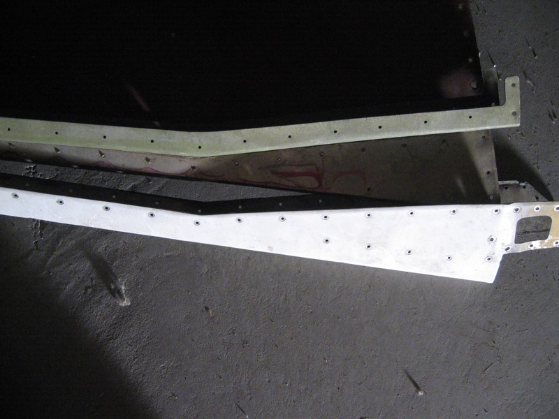

Here are some pics of that reinforcement piece, at least you'll know what to look for.
channel and leading edge.jpeg (98.23 KiB) Viewed 16958 times
channel on top of stab, leading edge in front.jpeg (93.81 KiB) Viewed 16958 times

Thank you David, by looking at the pictures you sent it appears this is a channel that fits top and bottom of the leading edge under it's lip or overlap of the stabilizer. Is this a service bulletin if it's not installed? I know it's not an AD unless I am overlooking one of them. I will look an see next time I am out at my hangar. Thanks again!

Seems like this reinforcement would be a good idea to add at some pioint if anyone has a part number.
