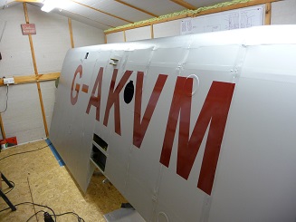

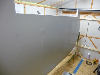

Have you considered Oratex 6000....
A superb product requiring no painting.
- cover61.jpg (43 KiB) Viewed 4161 times
- cover55.jpg (36.01 KiB) Viewed 4161 times
