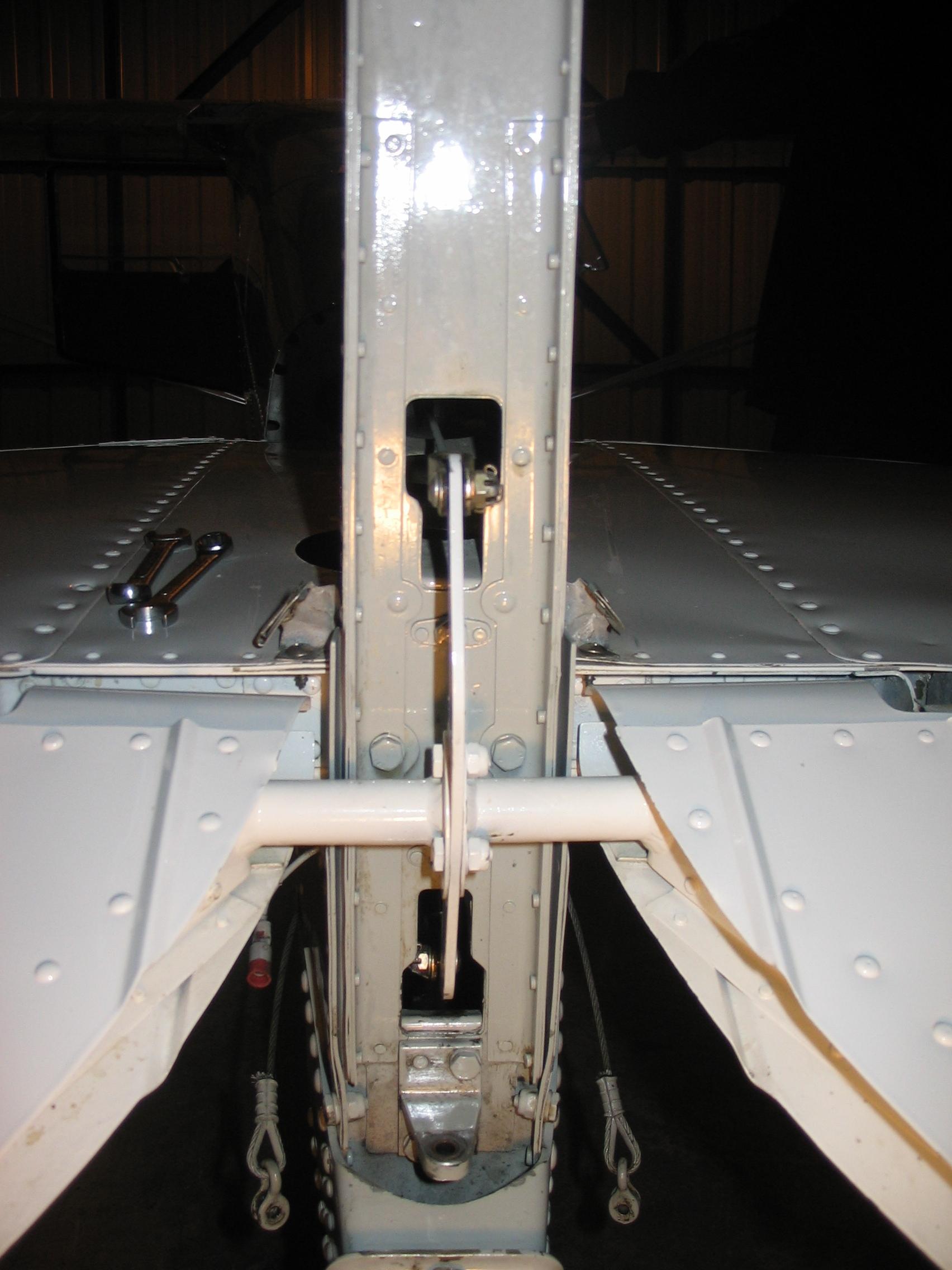

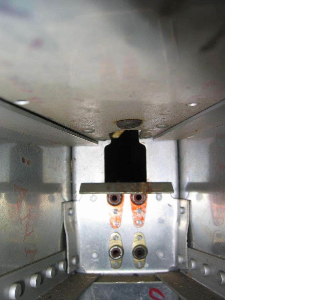

See if you don't already have the mod done. Also, there is a bulkhead reinforcement that you can see from behind the tail thru that squarish hole for the elevator control cable...
Here's a listing of AD's from the Univair site
https://resources.univair.com/docs/cess ... 170-series
If you are registered on this site you can go to the Resources section on the main website and download Service Letter 57
- rearbulkheadADfix2.JPG (63.77 KiB) Viewed 3304 times

Re: AD 50-31-01
Great diagram and pics - thanks!
